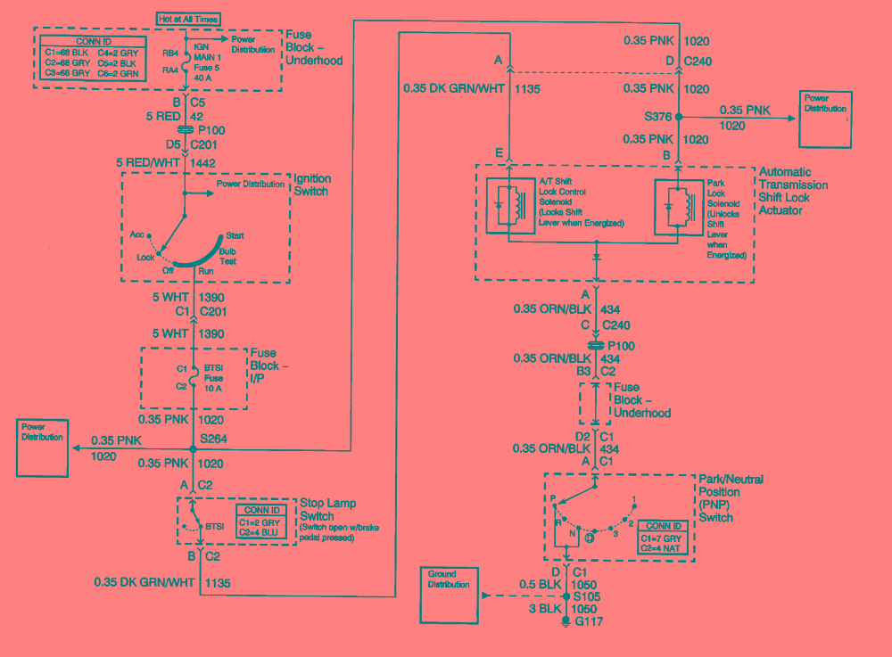

Just bought a 2002 Pontiac grand Prix. Shifter interlock isn't working. Anyone have a wiring schematic of the shirt interlock circuit. Thanks in advance

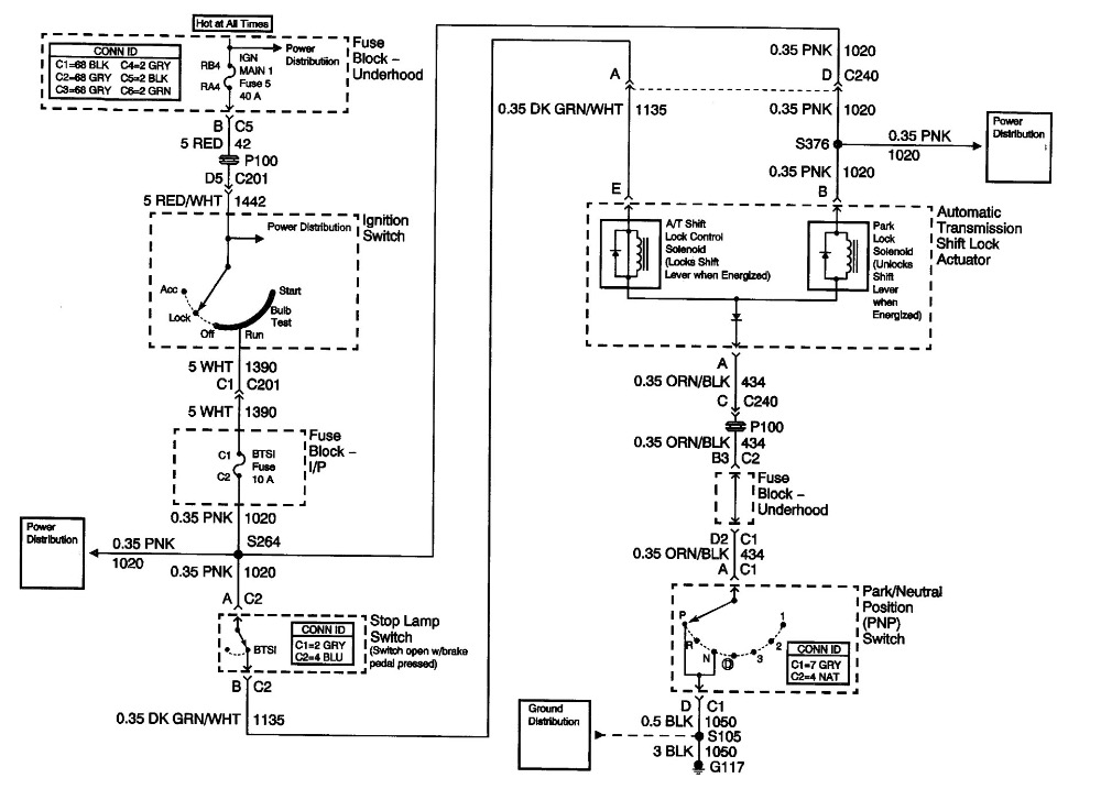

Here.
