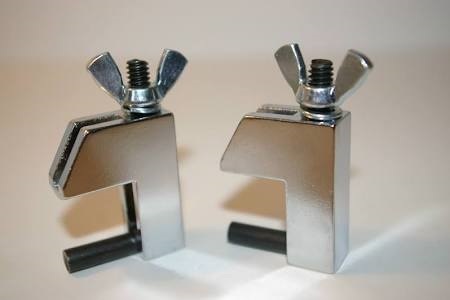

(3) The next simple test is looking for a faulty seized caliper or a drum brake self-adjuster that is slipping back. You can do this by off clamping each rubber flexible brake hose in turn and test the brake pedal travel. Ideally you should use a proper brake hose clamp (sometimes called a hose nip or hose pinch) but with (great) care you can use a pair self locking grips but pad the jaws with several layers cloth to avoid damaging the rubber hose.

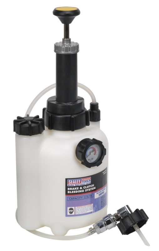

For some years now I have used a pump up pressure brake bleeder as some brake master cylinders are very difficult to bleed by the old style pedal pumping method and vacuum bleeders sometimes pull air into the system past the rubber seals.
