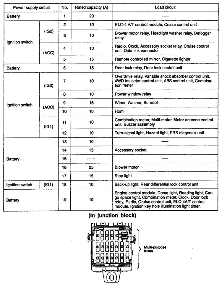

Hi......I am new in this forum...My name is Angel Santiago...I am from Puerto Rico. I enjoy learning about car electronics and everything related to
it...I joined the forum and eventually will subscribe to the scannerdanner youtube premium channel so i can learn more about vehicle troubleshooting. Right now i own a 1996 Mitsubishi montero that cranks but no start....has no spark, check engine light does not lid on the dashboard....there is no 5 reference volts at the sensors....and i cannot find the location of the engine power relay, so i can test it. I hope that i will find the solution within this forum and the youtube tutorials....

6 years 6 months ago #38967 by jreardon
Behind right side of dash, above ECM

6 years 6 months ago #38975 by John Curtis
Replied by John Curtis on topic HI.......I am new in this forum. Crank no start.
But to circle around real quick, to you test all the sensors for 5v? The reason I ask is because depending on the sensors you’re checking you may need to unplug before you’ll see the 5V (thermistors)
If no 5V then check powers and grounds for the ECM.
You need to verify your ECU FUSE is good. Mitsubishi tends to throw out a bunch of stuff on one power feed. So if it’s a blown fuse don’t touch anything before doing a visual inspection. Do you have a test light?

6 years 6 months ago #39103 by Tutti57
Remember though, that you have to confirm power and ground at the ECM as mentioned. If you have those, then one of the sensors could be bringing the whole 5v ref down.
If you have power and ground at the ECM, start unplugging engine sensors until the 5v ref comes back up then you will have found your problem. Thermistors aren't going to be the issue due to them having a different design as outlined in Paul's book.
If you don't have good power or ground at the ECM, then you have a heck of a good direction to follow!
