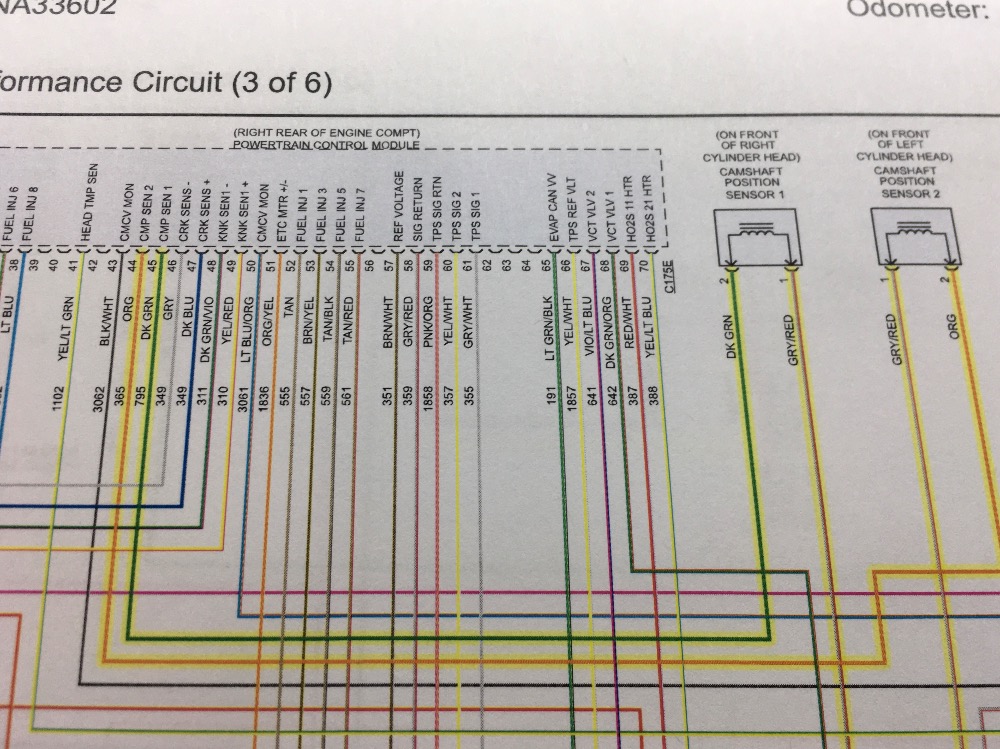

Am I supposed to have a supply voltage(KOEO) on bank 1 and bank 2 wires that come directly from the ECU?
These CMP create AC voltage.

I'm dealing with the same thing on an 08 mustang. These are VR sensors. They are supplied by a 12vdc + bias voltage. Or in some cases a - bias voltage or in some cases both. Some fords have a floating ground. If that is the case scope the + side and - side of the cmp sensor.

I have no voltage on the wires from the ECU And no waveform when cranking. Ground wires are good.

how are you hooking up your scope? Yellow to cmp + and black to good ground?

Bank 1 CMP scope yellow to dark green
Scope ground to battery

try setting up the scope yellow to dk green and black to gray/red on the other side of the sensor. Check out section 21 of the book on VR testing. A lot of good information there. Do you get a cmp signal from cmp sensor 2?

I'll be double dog damned. I did the same thing on a wheel speed sensor. A while back. Thanks. I have to wait till Monday now.

Thanks again. I'm watching the case study with the VRS case study right now. I kept searching CMP testing in the book. I know that the F150 has timing chain issues. I just couldn't figure how to get a waveform.
