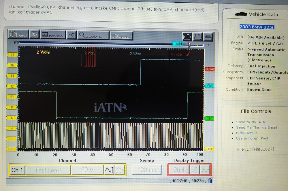

6 years 6 months ago #39195 by BLEE
Hello, I am looking for a known good intake/exhaust cam/crank waveforms for a 2001 BMW 325CI 2.5L. The issue is it has a P0014 (Exhaust Camshaft Over Advanced). It uses the VANOS system and I ensured that the exhaust solenoid valve is operating correctly. Any help is greatly appreciated.
Thanks, Brian

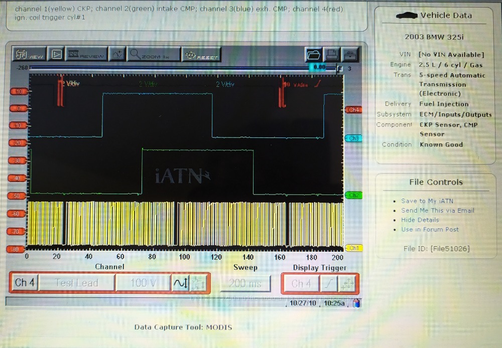

6 years 6 months ago #39197 by juergen.scholl
Replied by juergen.scholl on topic 2001 BMW 325CI 2.5L (Cam & Crank Waveforms)
This is from a 2003, it "should" be the same....
Credits for the fotos go to Kerry Marion, NOT me.
