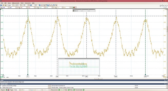

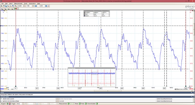

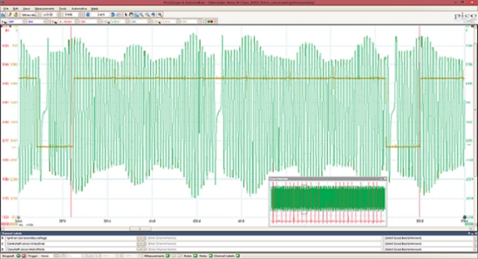

Hi all ! First time on the forum so hope I'm doing this right ! I'm a diy guy and I'm working on a 2003 Mercedes ml500 it seems at idle that it has a misfire which goes away as soon as you raise the rpm no dtcs or miss fire monitors .you can here it miss through the intake by way of a light popping ,so I thought of a bad inlet valve ? Just done a leak down and all are between 10 to 14% which didn't seem to bad with all leaking evenly between oil and intake as best I can hear . It did have positive fuel trim total of 6% bank 1 and 8 bank 2 but new plugs brought down to 0 with short term switching from -1to +2 so no problem there .i don't have a presure transducer for my peco but have done a relative compression ( starter current and signal from spark plug 1 and it appeared that the bank 1cylinders (1234)had there peaks on average 6 to 8 degrees after where there coil would fire (added in the 8 X 90 deg divisions ) thinking of a slightly stretched timing chain ? Can I really use the current as accurately as that ? I've just done a cam crank waveform with coil 1 which looks ok but need a known good ?.? If anyone could help with a waveform I'd really appreciate it oh and it only has 1 cam sensor and it's on bank 1. Thanks Chris

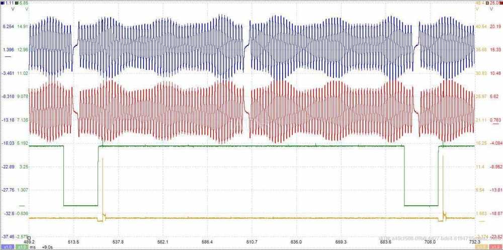

Late to the party, sorry guys! I found something on iATN:
There's not much info to go with this capture, but I'd guess that the red and blue traces are both wires on the CKP, and the green trace is the CMP. Yellow is an ignition sync, probably cylinder #1?
Hope this helps. :)

hi thank you very much for the post ,it is as you described athough i only picked up one wire from the ckp, green is indeed the cam and i think your correct with the yellow being no1 athough mine is dead in line with the trailing edge of the cam but thats at cranking and this may well be running . so from this i would say my timing is fine .i have tried to upload my waveforms but it will not have it so i need to find out whats going wrong .very kind of you both to take the time to help regards chris

IT WORKS !!!!!! THIS IS THE RELATIVE COMPRESHION WAVEFORM WITH NO1 IGN FIRING ORDER IS 15486372
THIS IS A RENAULT CLIO 09 1.2 SAME TEST BUT A 4 CYLINDER . NOT SURE IF IT WILL BE CLEAR ENOUGH SINCE I RESIZED PIC BUT ON THE ML500 WAVEFORM THE SPARK EVENT ON 1234 ARE ALL BEFORE THE PEAK ABOUT 6 TO 8 DEG YET 5678 ARE NEAR AS BANG ON ,THE PICK MAY NOT SHOW THE 8 X90DEG LINES

AFTER HAVING A BETTER LOOK MY TIMING IS OFF !IF YOU MOVED YOUR GREEN CAM ALONG TO TOUCH THE YELLOW TRACE THIS IS HOW MY WAVEFORM LOOKS ,MY GREEN CRANK IS YOUR BLUE AND THE TRAILING EDGE OF THE SINK IS NEARLY IN THE MIDDLE OF YOUR CAM BUT ON MINE ITS ABOUT A 1/3 . THATS GREAT NEWS THANKYOU

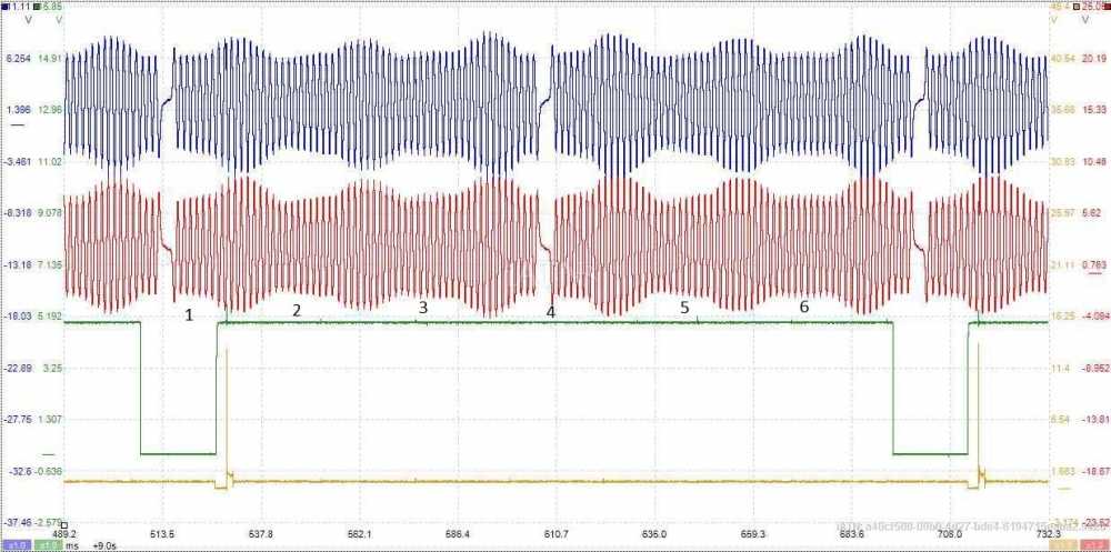

Do you think the fluctuations in the A/C signal indicate that this was a cranking capture?
9 years 9 months ago #5374 by Tyler
Replied by Tyler on topic Mercedes ml500 cam / crank waveform 2003
Noah wrote: Do you think the fluctuations in the A/C signal indicate that this was a cranking capture?
Maybe? ChrisG's waveform shows the same oscillations... Good eye, sir!
Now I'm looking closer at the CKP signal... this is a V8, right? So, there should be eight points in 720 degrees where the engine 'slows down' to run a cylinder through it's compression stroke.
I only count six? I'm not saying Chris is missing compression on two cylinders, I'm saying I can't be looking at this right. :lol:
Yeah, good eye. That's hard to justify...
Even the known good has only 6 of those "events" per 720 degrees of rotation
