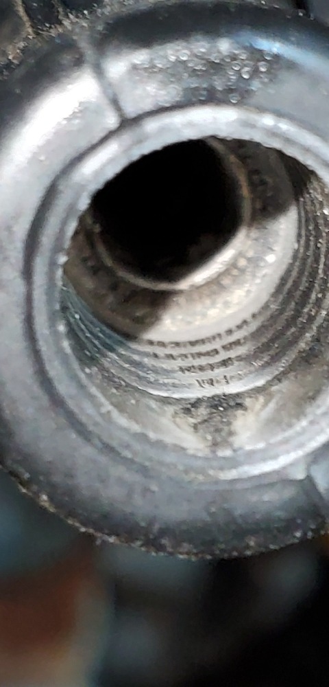

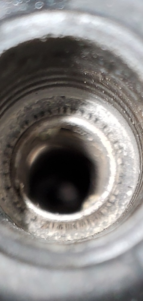

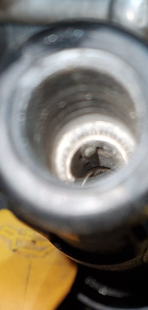

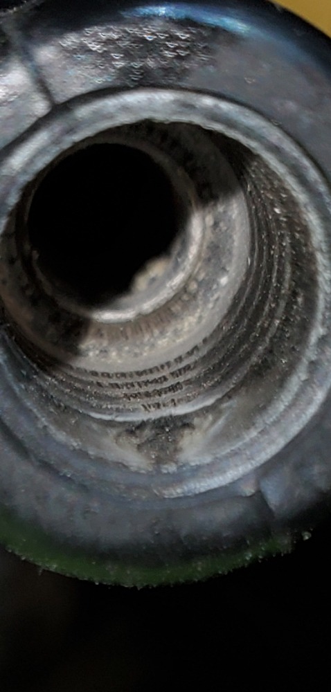

So I did some checking and found the number 4 cylinder wire had some Carbon on it.
All four of the photos are the number for cylinder wire where it goes and the spark plug tube.
All the spark plug tubes were leaking around the O-rings and not any further down in the bottom. So I just need to stick a rag in there and wipe around it and clean it up then pull the, plugs,
valve covers and replace the O-rings, valve cover gaskets and I will check the spark plugs as well.
I was able to get some video which I will have to upload later of the spark plug tubes showing how little amount of oil was in each one but clearly spark plug wires have been used over and over again as they have like a dried caked on Oily residual dirt on the spark plug end that goes down in the tube.
The video I took is a little bit of rambling and such so I will probably cut the audio and just do a voiceover. Maybe if I do it right I can fill in for Mike Rowe someday, I'm dreaming.

Hey, that's a carbon track. B) Easy breezy. The Mode $06 and Freeze Frame data would be fun to check? But I'm pretty confident you found the problem.
Noah is right - that noise from the TB is totally normal. Don't sweat it.
I also agree with Noah about the repair. Do the plugs + wires, the valve cover gaskets, and leave the potential head gasket issue for another day. ;) Give the vehicle owner the heads up and let them budget for it. These head gaskets CAN be done in the car, but it's not fun. So much easier to pull the engine and get it on a stand.
