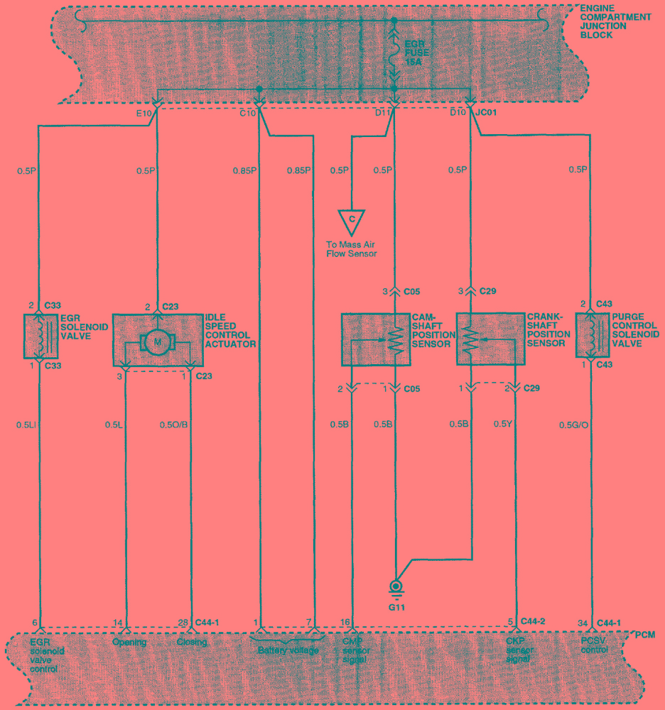

Hi does anyone have a wiring diagram for cam sensor I have a po340 and a po300 but I'm thinking i should fix sensor problem first and misfire might go away this vehicle also had an interlock Devise on it and I'm not sure how that wires into starting system thanks there is misfire on engine battery voltage seems ok and starter motor worked fine

By any chance are your lights flickering? Like headlights or interior lights? I’ve seen several Hyundai’s have problems with a bad diodes causing both codes due to excessive AC ripple. Not saying that is your problem, but you could quickly identify AC ripple on a 2V scale with 10 ms per division. A bad diode would be .5v AC peak to peak.
