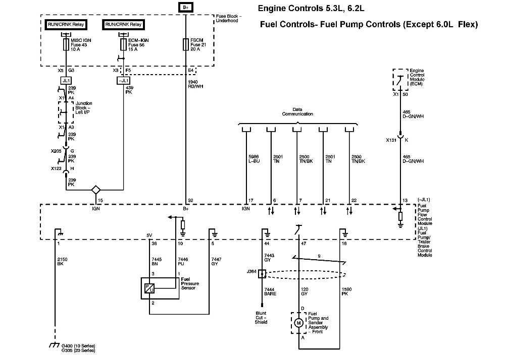

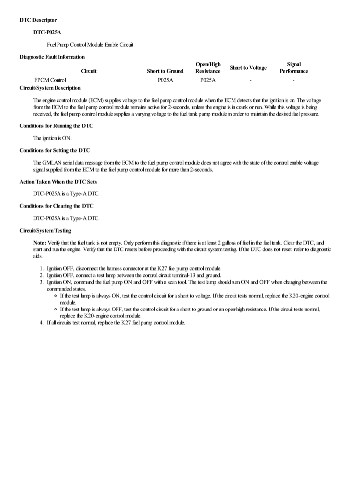

2011 TAHOE DOES NOT START with a code P0230 and P025A , I checked the fuse and Grounds in FPCM but still does not start..Any Idea on this car !,Thanks

Pretty straightforward test. I’ve included test procedure and a wire diagram.

Thank you jhon, Here is what im donn on this car , i checked Bat, and ignition feed ,grounds Of the FPCM, ITS WORK FINE . i disconnect FPCM connector and check for No 13 wire which is Fuel control relay from the Power contro module supply voltage to FPCM is not working , I checked integrity test its fine and so I decided to put a old ECM . reprogram and now its works fine ,, Thank you
