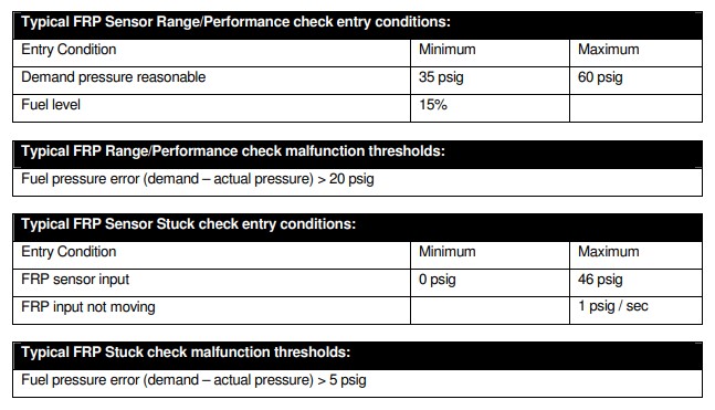

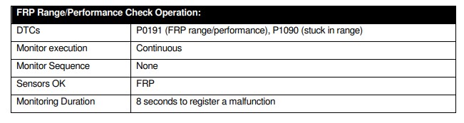

6 years 6 months ago #39517
I suspect you were experiencing an in-range failure. The sensor signal may have been skewed, but not skewed enough to trip any of the traditional P0190/P0191/P0192/P0193 codes that these sensors usually produce when they fail. For example, here's the code set criteria for P0191 on your truck:
www.fordservicecontent.com/ford_content/...orcraft/OBDSM804.pdf
The kicker is the monitoring duration - eight seconds. :ohmy: I dunno if this problem happened for eight seconds or more at a time? But that's a huuuuuuge amount of time when you're talking about catching intermittently failing components.
