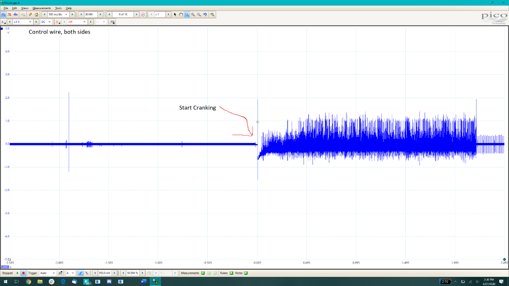

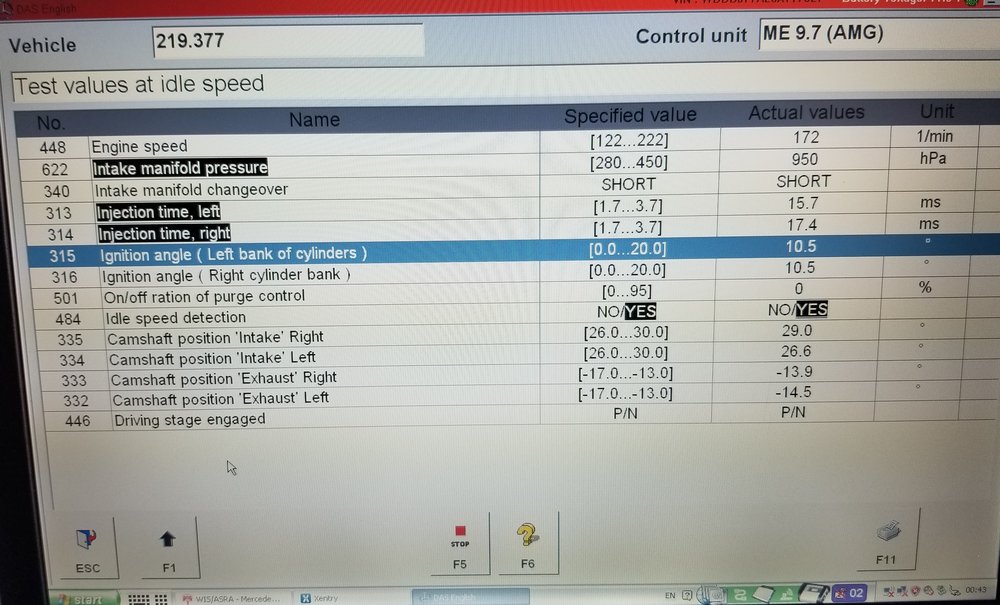

I found that the left bank of coils was left ungrounded. I screwed that ground down and tried again, only to get the same result. I saw smoke come out of the intake manifold this time. This only happens with injectors plugged in, so I want to avoid cranking with injectors until I see something that tells me to try to start the car again.

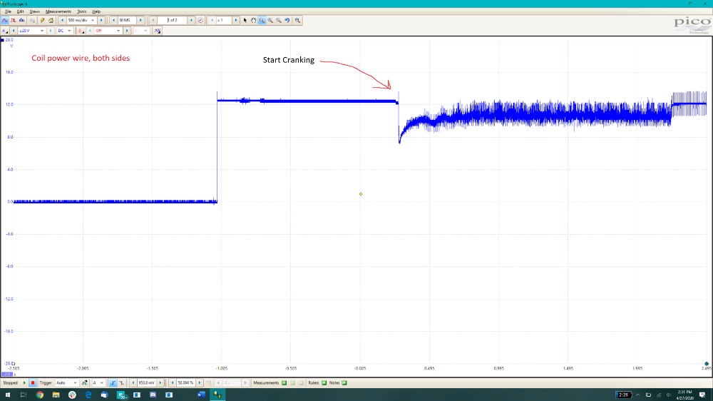

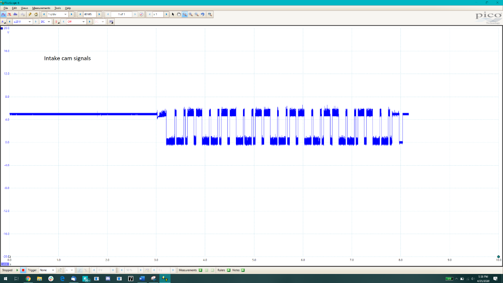

I initially thought that the car was firing the coils while fuel was being sprayed into the cylinders. I checked the intake cam signals on both sides and the square wave looks the same on both sides. The signal was very noisy, but the car was cranking. I haven't checked the crank sensor signal, but I never touched that during either job. I am not sure where I would find a known good waveform anyway.
I then checked the four wires on one of the COP ignition coils on the left side to determine if they were firing at even intervals during the crank. The power wire was fine, the ground wire was noisy, the confirmation wire was always 0 volts, and the signal wire was essentially the same signal as the ground wire. I checked a coil on the right side and found the same signals. They're in the images below. I'm assuming that the one unique colored wire on each coil is the control wire from the ecu, and other three are power, ground, and confirmation.
Although I didn't find any strong diagnostic reason to do so, I pulled the fuel rail and injectors out of the manifold and checked for stuck open injectors at the request of someone close to me.
Thankfully nothing on this car is hidden under a manifold. I can probe just about anything you guys would need to see. the crank sensor is a PITA to get to, so I'd rather not probe it, but I can if I have to. The common ground wire for the left side of coils seems too tight to get an amp probe around. The right side seems annoying, but doable. I only have one current clamp and one voltage probe atm, so that is all I can show on the scope atm.

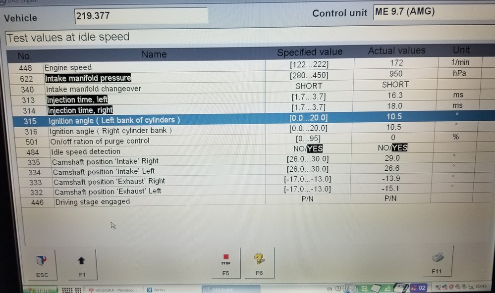

Here are some more photos of live data during the crank without injectors plugged in.

Will unplugging injectors cause the computer to stop firing the coils?
Possibly. Do you have current codes for the injector circuits with the injectors unplugged?
A test you could do would be to plug in the injectors, but don't reconnect the fuel pressure line to the rail(s). Or remove the injectors from the rails and plug them into the harness. Run the fuel pressure lines into a bucket, disconnect the pump, or whatever you can to stop fuel spraying everywhere. Clear the codes, crank it and see if spark comes back.

I could be way off, but I'm reasonably sure that MB doesn't use a confirmation signal on their four wire coils. Pretty sure it's like other German makes, which actually use that fourth wire as another ground.

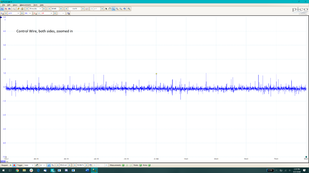

Why would the control wire mirror the signal of the ground wire?
It's not really a signal you're looking at, just noise coming off the block during cranking. There'a a lot of current going through the engine at that point, and other circuits are gonna pick up some of that interference. The same kind of noise can be seen in the coil power capture. I wouldn't read too much into it just yet.
You can also end up seeing that kind of noise just from your scope leads. ESPECIALLY on a Pico with the sensitivity turned up.

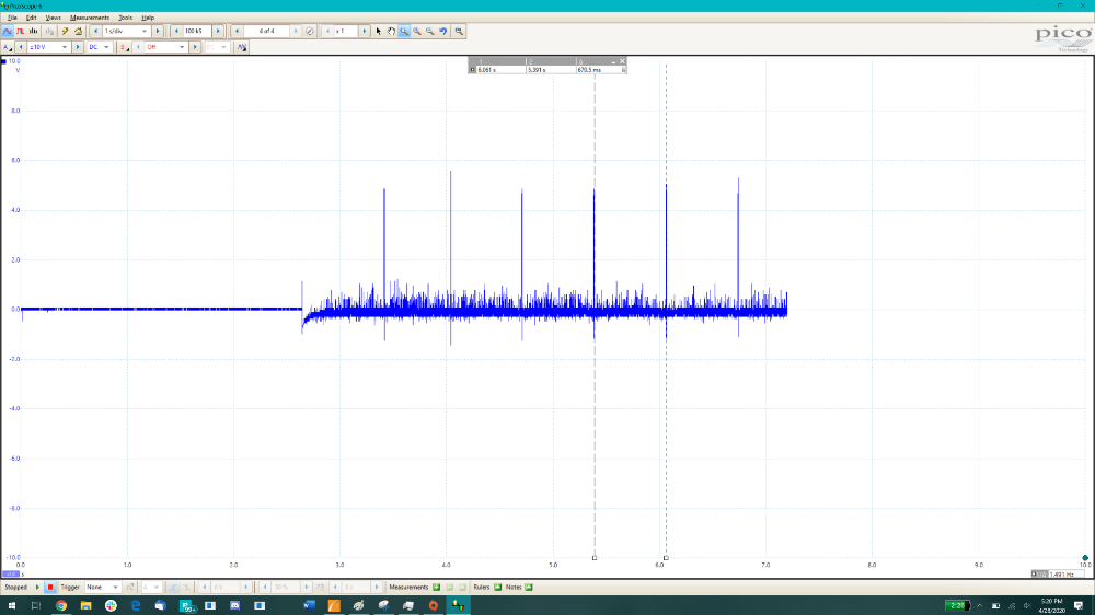

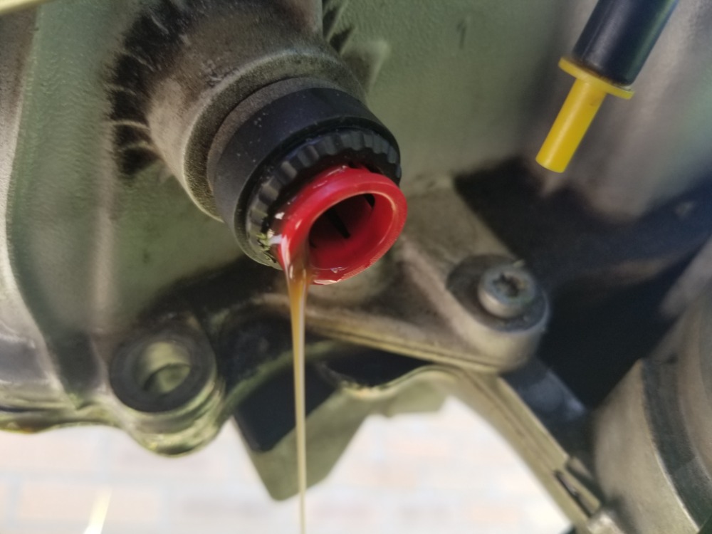

I went out and managed to plug the injectors in without getting fuel into the cylinders. I watched them fire outside and the spray pattern was what I would expect. No crazy flow or anything. I started checking all the coils for control and started seeing the square wave I expected. I was testing the cylinders one by one, until I got to my 7th cylinder and heard something squirt out of a cylinder on the other bank and immediately stopped. I was doing the spark tests with only one spark plug and coil in at a time to avoid any damage from stupid oversights. I only got two squares on the last cylinder I tested, and they are timed about 150ms closer to each other than any other cylinder I tested. I always measured in the middle of cranking and not at the start of the others though. It is possible this is just due to the starter speeding up at the start.
About the squirting: it was oil. When the headgasket blew last time, coolant mixed with the oil and got past the PCV. It let a ton of coolant and oil in the manifold. I let it drain while I did the job, but there is still a lot in there I guess. I have no idea why it waited for me to test 7 cylinders before drawing oil in. I highly doubt that the cylinder pulled enough vacuum to pull oil from the head gasket with no spark plug installed, so I think the manifold is the only place it could come from. my next step is to pull the manifold and see how much oil is sitting in there with my boroscope. I won't do anything else with spark until I do that - my biggest goal here is to avoid damaging anything.

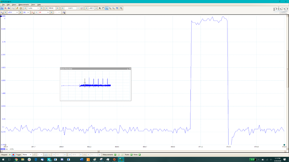

I've attached pictures of what I see on the control wires. They're all the same except for that 7th one. I neglected to save that waveform, but it is very similar. The squares are just closer. I'll investigate more when I can. I haven't checked to make sure the coils are all working, just that they're being commanded on so far.

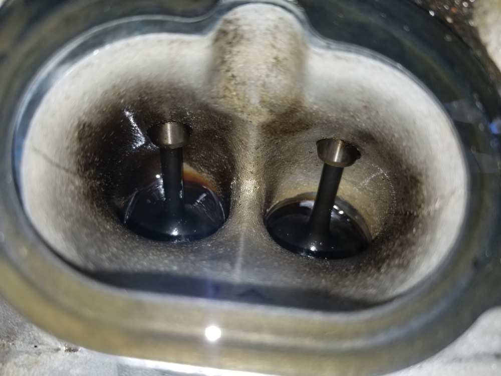

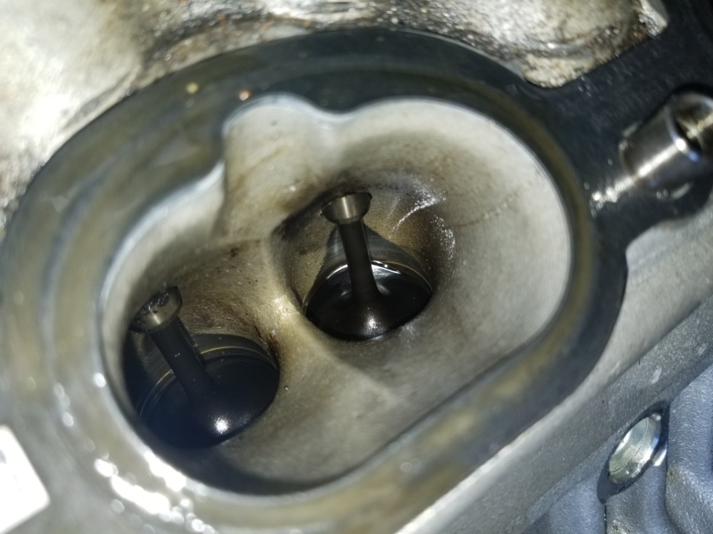

I managed to get the intake off for a second inspection. There was a lot more oil in there than I thought. A good amount drained out and some was left sitting on the intake valves of some, but not all, cylinders (pics below). I separated the intake to clean the inside out to make sure there was no oil left. I'll put the manifold back on when I can. I'm leaving to go pick up a new PCV valve and some parts for other cars in my personal queue.
I'm not sure when I'll have time to put this back on, but I'll make sure to update the thread when I do.

abdullah.kose wrote: Is it possible for a 4 wire coil to just go haywire and fire when it wants to, even if there isn't input from the computer?
Possible, but unlikely. The only way this would happen is if the control wire was intermittently shorted to power.
Remember, the coil signal you're seeing on the scope isn't just a suggestion from the PCM. ;) Current flow through the coil starts and stops based on that square wave signal from the PCM. Without voltage on the signal wire, no current flows, and no spark occurs.
You're left with the PCM doing what it's programmed to do based on its inputs, OR an intermittent short to voltage on the control wire. I can count on one hand the number of times I've seen an intermittent short to power.
Interesting! So do you believe that the square wave for coil control only came back after electrically reconnecting the injectors?
I can't say I've ever tried disconnecting an injector on a MB then checked to see if spark came or went on the same cylinder. Might be valuable for future diagnostics...

I then repeated the test I did earlier on the last two coil control wires. I saw consistent timing on the square waves that popped up as as I heard the air compress in the cylinder. It was the same 670ms or so as earlier while cranking with only one plug installed. I checked for excessive fuel spray again (I'm terrified of hydrolocking this thing) before putting it all back together and turning the key. It smoked a bit on startup, but that soon went away. I let it sit idling for over 25 minutes until I was satisfied that there was no smoke coming out of the tail pipe. This was far longer than it took for the car to smoke the first time around. No overheating or anything this time.
I don't really know for sure what fixed the issue. I suspect a two things though. Some coil connections were soaked in oil for a while because they sit below where oil drips from the valve cover area. Maybe that was shorting the control signal high somehow. I never cleaned them because I wanted to see the issue happen on the scope if that was the case. Maybe the oil dripped out in the silly amount of time it has taken me to get back to this.
There was definitely a liquid oil coolant mix in the manifold before I rebuilt it. I cleaned it out and replaced the pcv valve to make sure it wouldn't happen again. Oil in the intake manifold is a terrible thing for the car, but how would that cause popping?
