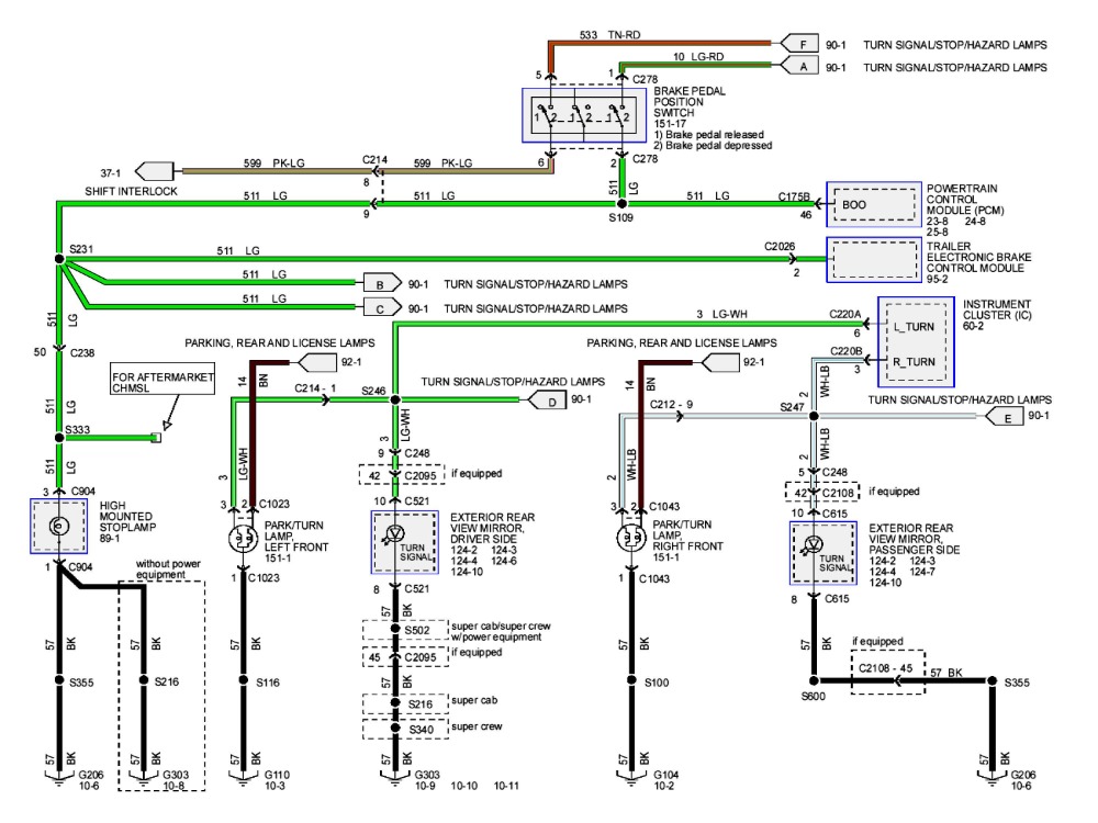

Turning on the four way flashers also sets the codes in the ABS module.
Using the left directional sets the codes and kills the rear wheel speed sensor.
With the left tail lamp disconnected, turning on the left directional does not set the codes, however pressing the brake or the hazard lamps still does.

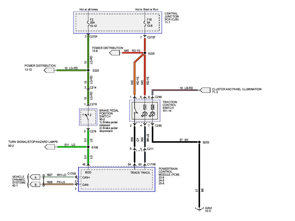

The brake pedal position switch is a 4 wire switch.
Jumping the 2 green wires sets the codes, but the jumping the other two does not. So the fault is related directly to that circuit. However, this is not a direct input to the EBCM.
I have disconnected the trailer harness, the trailer brake control module and all the stop lamps to no avail.

“ Using the left directional sets the codes and kills the rear wheel speed sensor.
With the left tail lamp disconnected, turning on the left directional does not set the codes, however pressing the brake or the hazard lamps still does.”

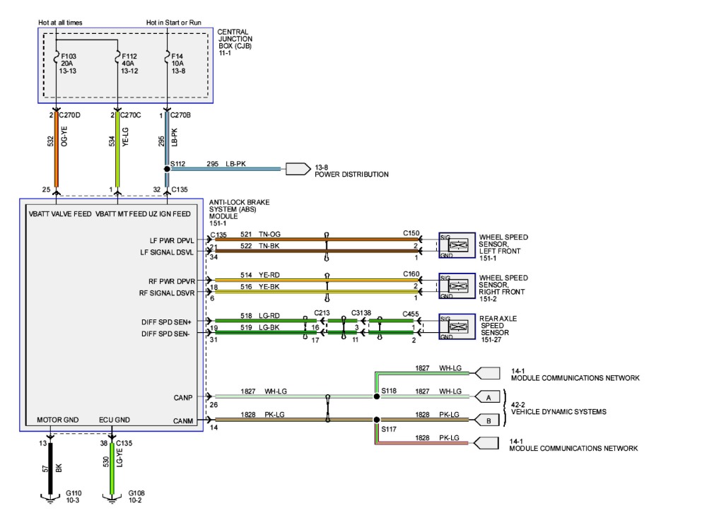

I’m choosing to latch onto this. I’m wondering if it’s a ground issue on G110.

Like you said, there's no direct BOO input to the ABS. It comes networked from the PCM. So, I wonder what would happen if you disconnected the PCM, cleared the ABS codes and tried again?
It'll set U-codes, sure. But if you can hit the brakes and not set C1230/C1237, then I'd suggest that the problem has to do with the ABS module, and the BOO message from the PCM. If the codes reset, then I'd probably dig a little deeper into the RWSS circuit.

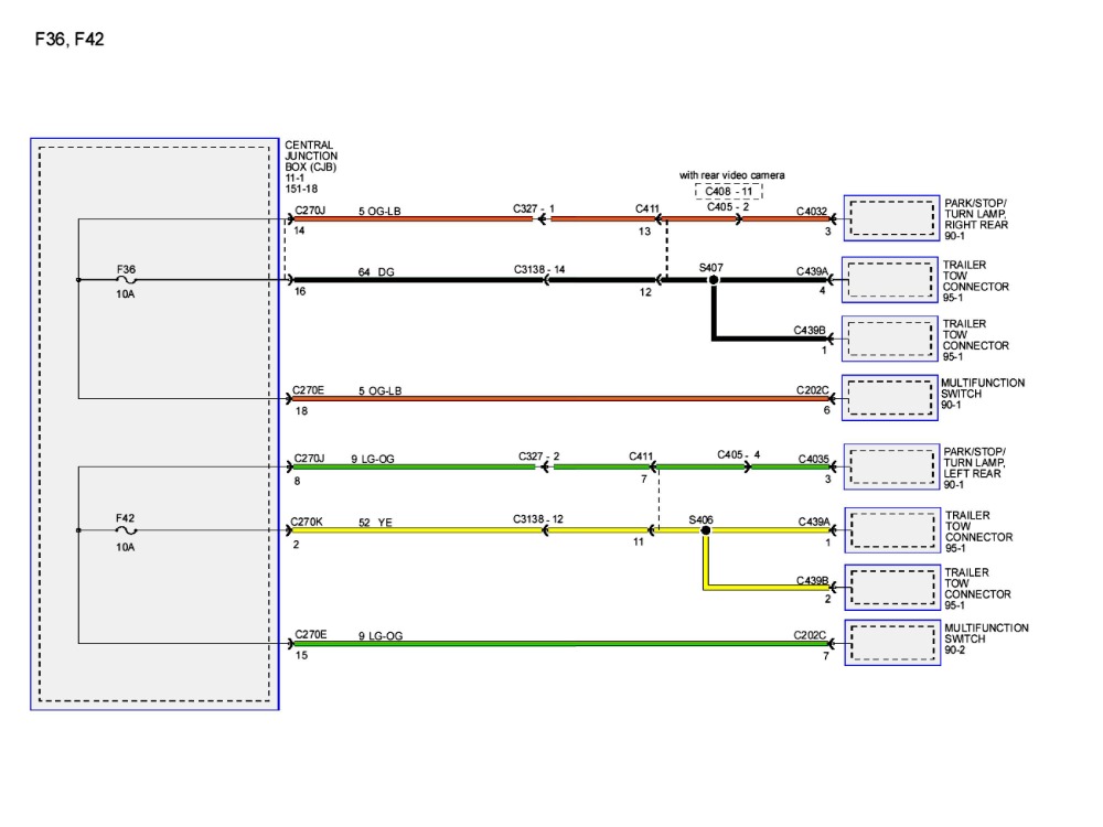

There is an after market trailer brake controller that is wired into the provisional factory connector behind the dash, but I unplugged that yesterday with no improvement and left it that way for now.
After studying the diagrams some more, I figured I could divide the lamps circuit from the trailer circuit by removing fuse #42 from the central junction box.
With that fuse removed, the problem appears to be completely gone!
Disconnecting the trailer harness connector or the connector before it in the harness under the bed (c411) makes no difference.
So it would appear that the problem lies in an 8ft section of harness between the fuse panel in the cab and c411 over the rear axle.
According to the OEM power distribution diagram, fuse #42 goes from the fuse box to the trailer hitch connector only.
There's 2 more connectors under the cab where the harness exits the interior. I'll see if I can further divide the circuit from that point and hopefully over lay a new wire for what I'm assuming now must be a crossed circuit some where in the wire loom.
At least that's the plan for now. See what happens in the morning.
I did volt drop test the ground at g110 at the suggestion of John Curtis and can verify that this is a good ground.

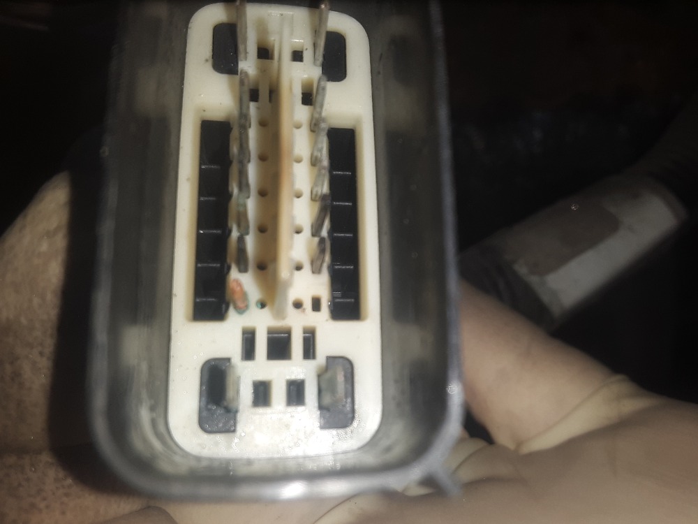

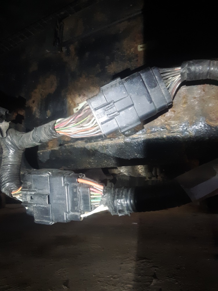

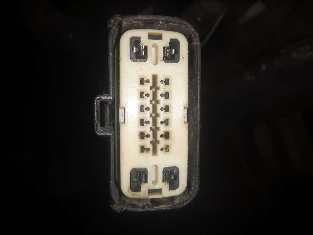

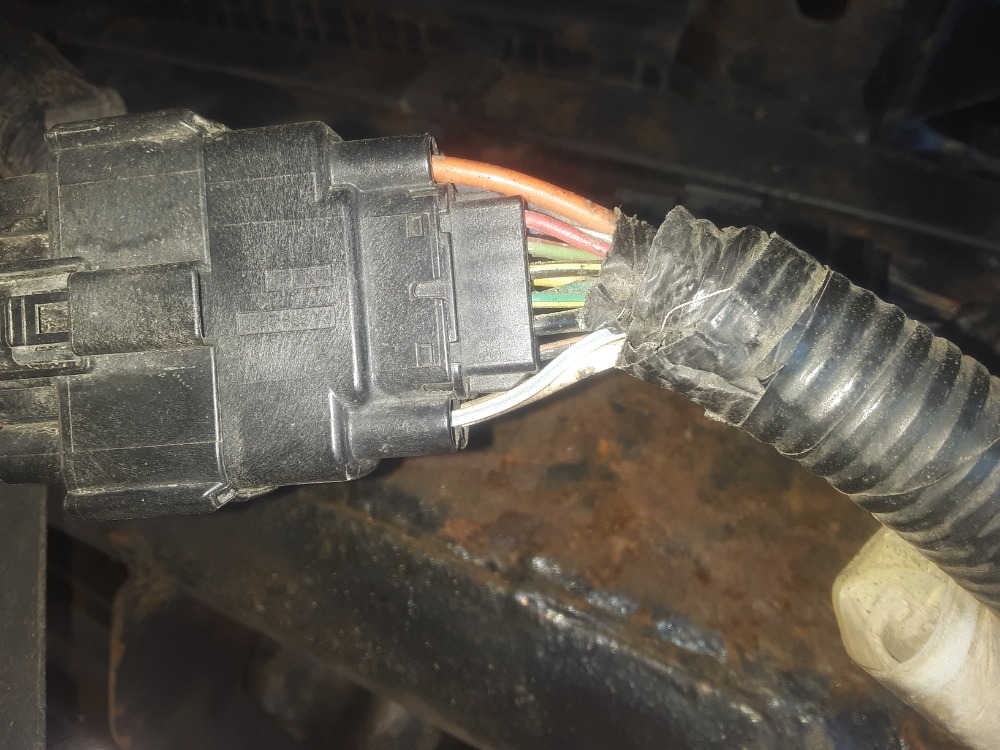

So in my attempt to divide the circuit between the fuse panel and the trailer harness, I found that the larger of the two connectors on the frame under the drivers door had water intrusion, corroding multiple pins.
Both wires in the rear wheel speed sensor circuit run through that connector, as does the yellow wire that is shown going from fuse #42 to the trailer harness connector.
I cleaned both ends of the connector with contact cleaner and compressed air and added a small amount of dielectric and the symptom has not returned. The customer has been made aware of the condition and will decide what repair option he'd like us to pursue.
I am having a hard time relating the symptom to the fault however.
Even if there was voltage drop on the rear wheel speed sensor circuit in that connector, how would illumination of the hazard/flasher/brake lamps have any effect on that circuit?
Could the contacts have been shorted together via the small amount of water still present inside the connector?
Any Ideas or wisdom?

Nice find!!!
You’re thought about the water shorting intrusion seems right. The only thing I could think of to have proven it would be to disconnect power and do a continuity check between wires/pins at the connector.

I have never experienced a crossed circuit within a connector due to water intrusion. I always viewed terminal corrosion as resistance in a single circuit, I didn't realise that the moisture would bridge contacts.
Fundamentally it makes sense, but it's something I hadn't experienced until now.

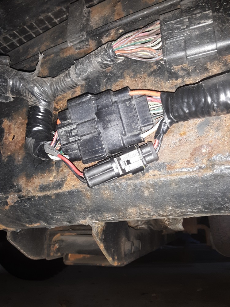

Rear wheel speed sensor connector bypass

Looks like it should have that way from the factory :-)

Andy.MacFadyen wrote: Looks like it should have that way from the factory :-)
Thank you, a coworker got those connectors from Wish
6 years 6 months ago #39752 by Tyler
Replied by Tyler on topic 2008 F 150 Rear wheel speed fun
Noah wrote: Thank you, a coworker got those connectors from Wish
Andy isn't kidding - that repair looks legit. B)
I dunno that I'd pick up on the repair during a visual inspection, unless I was looking for it.

Thank you. I'm going to look into buying an assortment of those connecters, I'm happy with the way it turned out.
6 years 6 months ago #39760 by Andy.MacFadyen
Replied by Andy.MacFadyen on topic 2008 F 150 Rear wheel speed fun
SuperSeal ?
