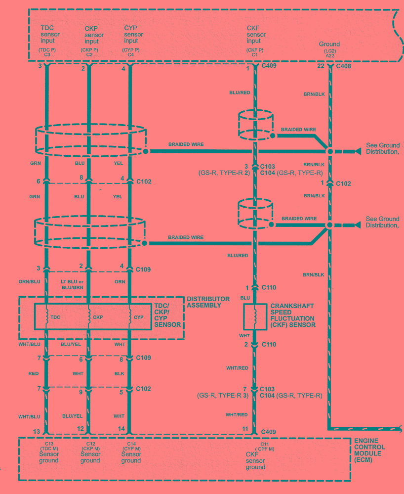

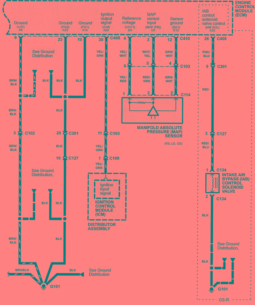

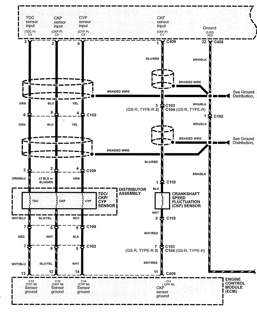

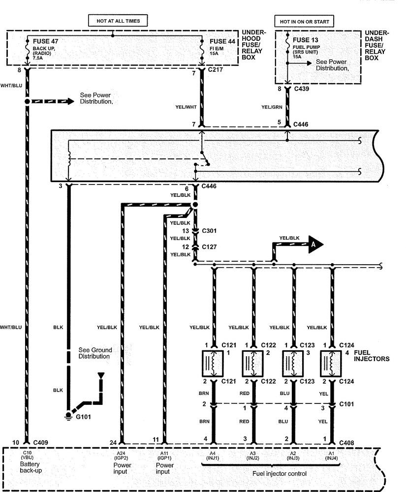

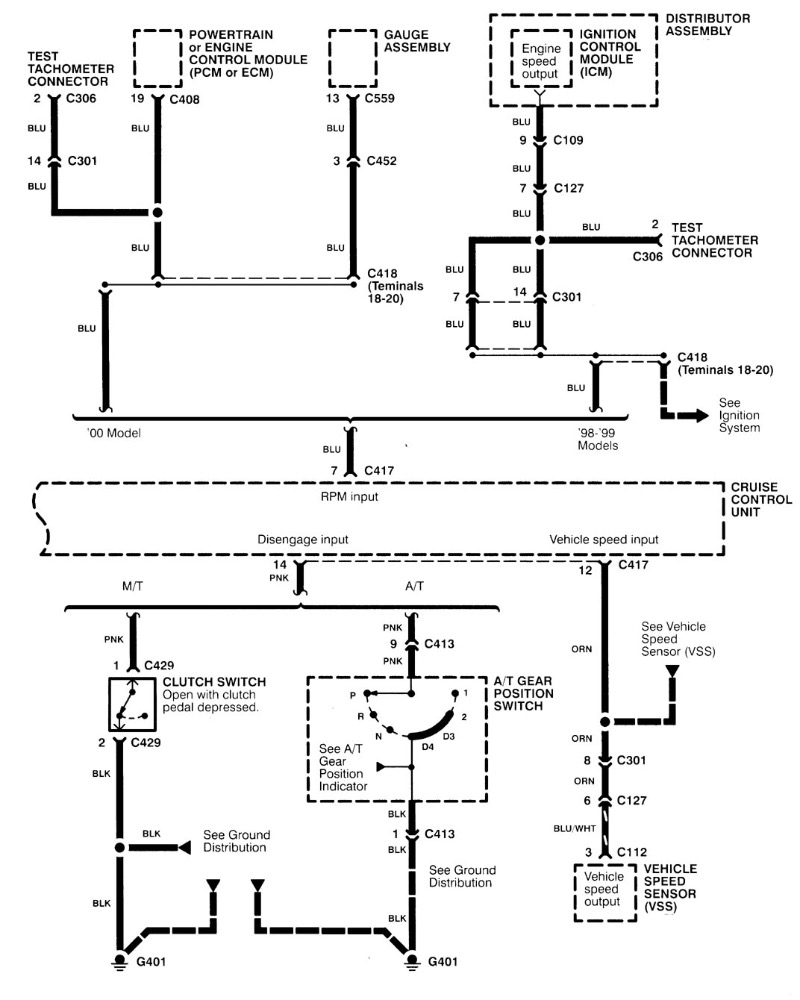

koeo = key on engine off
its true, with key on, engine off the check engine light should be on. then goes off after the engine is started. assuming there are no faults. This is a bulb check, and also ensures the ECM is getting power and working to some degree. If this is not the case, I attached a diagnostic work sheet. please review it and report back.
ignore the model at the top, it is a printing error, this is for a 1998 integra.
