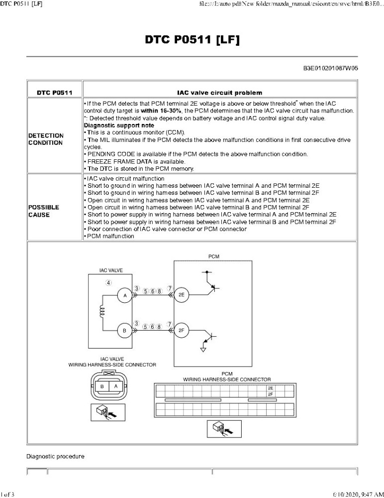

ok update about p0511
from my understanding p0511 checks lights on if the iac + is in abnormal values like in this case when I add load to the iac wire by plugging it in to iac the voltage in iac + drops to 7v which makes this code appear. ( Is this a case of voltage drop? )
IAC is a two wire IAC which lifts up the iron nail to open the bypass air.
notes*
IAC resistance is at 10.4 ohms
continuity harnes from IAC to ECM are good, no short to ground

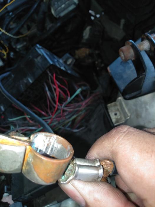

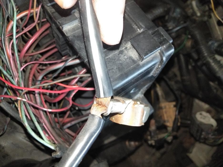

2.) I checked terminals positive and negative posts on the battery, and discovered that the negative terminal wire is corroded badly... Can this cause the engine light? p0511

sadly Im located in south east asia philippines. Yep, I think its a voltage drop, one culprit that I am thinking is it is probably the corrosion on the negative wire terminal on the battery post.

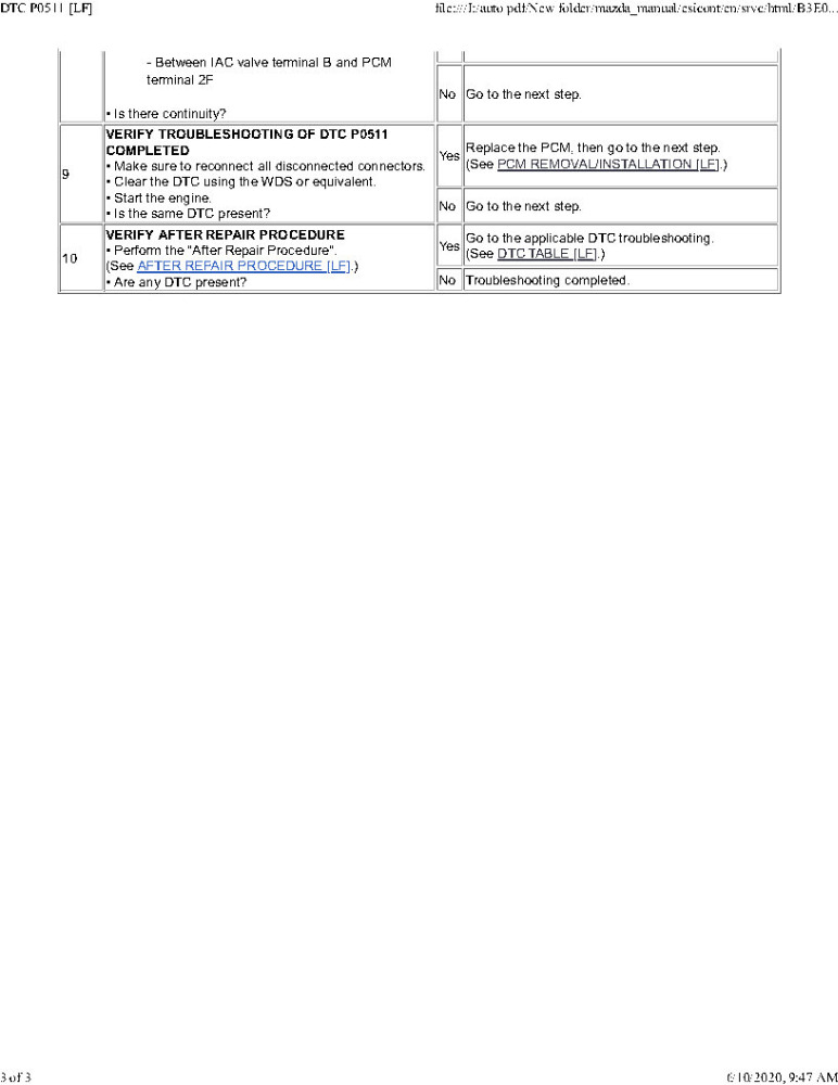

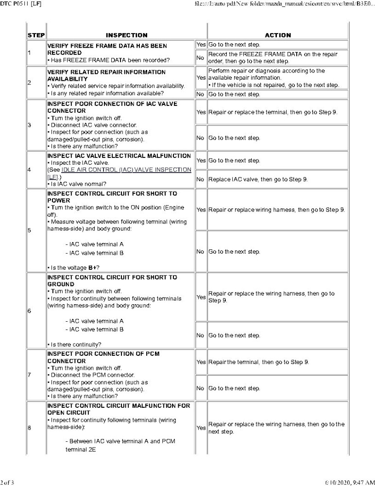

here is also the service manual for the p0511 code
