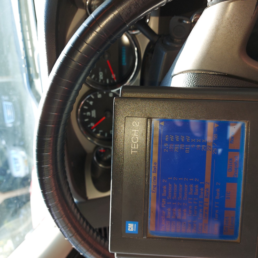

hello guys,
many garages failed..
my codes are p0171 p0174
new MAF
new fuelpump module now 55psi.
new catalyst
smoke tested, see nothing.
what could it be im lost

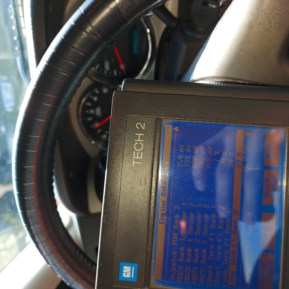

Was this screen shot at idle?? Try pinching off brake booster hose? What does fuel alcohol content read?? Fuel sample?

6 years 6 months ago #39649 by kool
Replied by kool on topic chevrolet silverdo fuel trims
this is at idle..

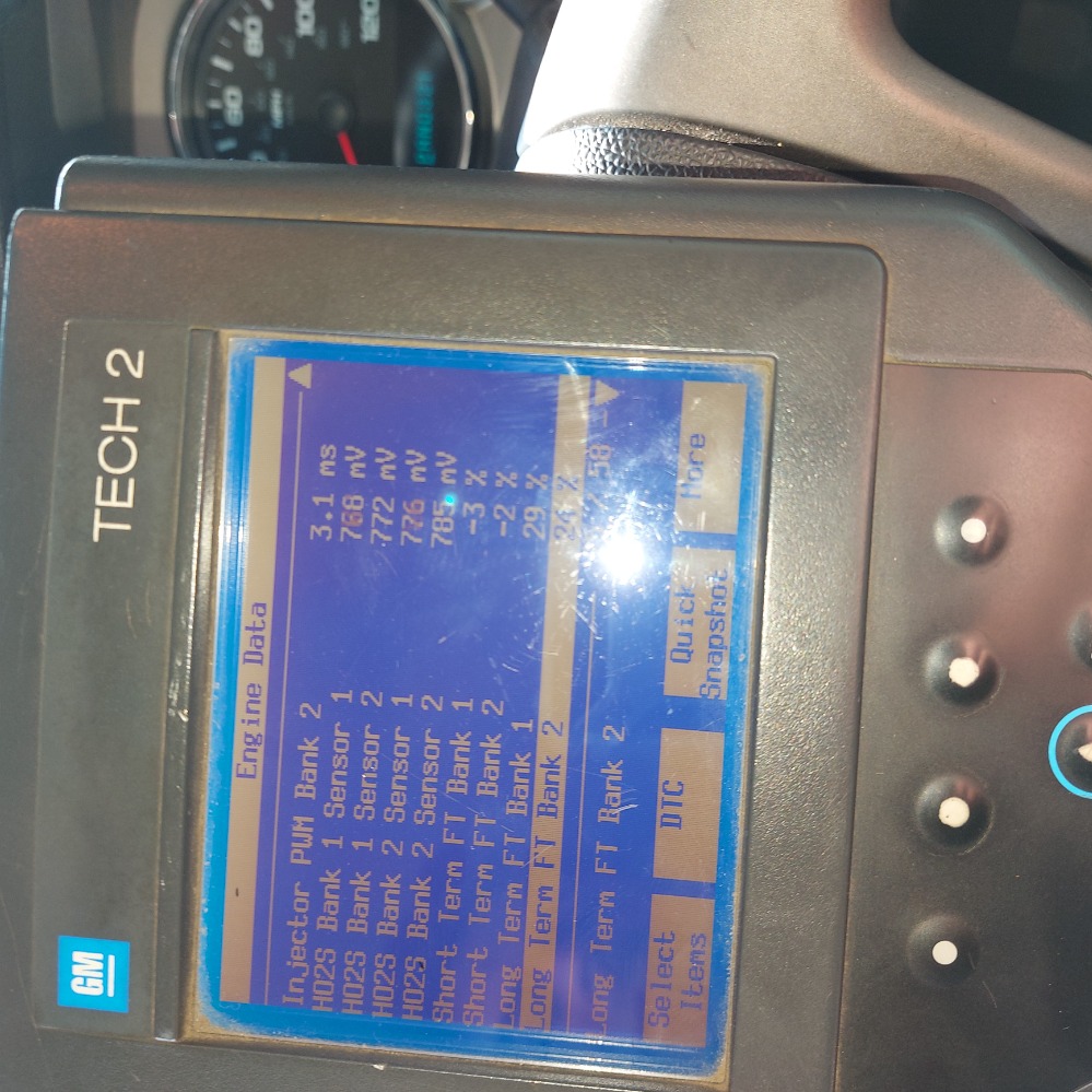

6 years 6 months ago #39654 by Cheryl
Replied by Cheryl on topic chevrolet silverdo fuel trims
What do the trims look like at 3000 rpm? Try a fuel trim reset after fuel pump replacement??? The short terms don’t look that bad in the pic
6 years 6 months ago #39657 by kool
short terms are oke! you always need to reset trims or they wil compensate by them self?

6 years 6 months ago #39675 by guafa
Replied by guafa on topic chevrolet silverdo fuel trims
Hi guys,
I think the problem is still there.
Is worth it (at idle) try to strangle fuel return line to increase a little bit the fuel pressure and see how fuel trims change. (Some time ago, I was figthing with a bad fuel pressure reg. which was giving me 55psi)
About trims, STFT should be about -29% after fuel pump replacement.
