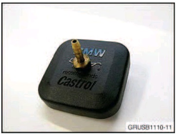

6 years 6 months ago - 6 years 6 months ago #39667 by tech25
Replied by tech25 on topic Lean condition
Hello, your engine is in fact a M54 engine.
common problem with crankcase vent valve, when engine is warm and at idle you should have a slight crankcase vacuum of 16 mBar. also, the cyclone oil separator had a hose that connects to the oil dipstick tube, that would rot and cause leaks also.
normally you check vacuum with special oil cap, or you could remove the oil dip stick and measure from the pipe.
measure vacuum please and report back,

The manifold has been removed, resealed and smoked with no vacuum leaks. The oil separator Ccv pcv valve has been replaced along with the hoses.
The STFT go up with acceleration
O2 sensors for bank 2 are recording .7 and .8
I do not have the special vacuum measuring oil cap but I did the test where you try to remove the oil cap while the engine is running and there is some vacuum but not a lot where it is difficult to remove the oil cap.
