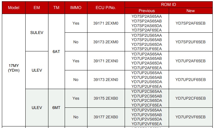

- tech25
- Posts: 86
- Thank you received: 27
6 years 6 months ago #39721
by tech25
Replied by tech25 on topic P0304 2017 kia forte
There is a software update to correct this issue. I attached the TSB, Please read.

- tech25
- Posts: 86
6 years 6 months ago - 6 years 6 months ago #39724
by tech25
this car should be under warranty. If the dealer just did this update, why did you not take it back??
also, with the scan tool with is the programmed part number for the ECM and the rom id?? can you post a pic of the ECM info from your scan tool??
Edit.. there is also a TSB out for RFI coils and the coils themselves. attached, read and follow.
