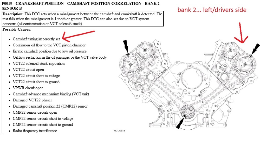

My fiancée's son owns this truck and is out of town for work. His truck started running rough, was misfiring, and has no power. Truck has 195,000 miles on it. About 5,000 miles ago he had four new Motorcraft cam phasers installed with aftermarket chains and guides. No problems after the repair until now.
Can anyone tell me where Bank 2 sensor B is on this engine? I can't seem to find this info anywhere. I found out that the B sensor is the exhaust sensor but don't know which one that is as well as I don't know which side is bank 2 on this engine. I assume these are the sensors on top of the valve covers on each side close to the front of the engine?

Bank 2 is on the driver side of engine. P0019 is a cam to crank timing issue with the cam position sensor or timing chain. Sensor is at the front outer side of the engine attached to the head just below valve cover.
To rule out the sensor, make sure its plugged in tightly first. If tight, wiggle the wiring. If the engine smooths out, you have a wiring issue. If not, swap the bank 2 sensor with the bank 1 sensor. If the problem moves to bank 1, P0017, then the sensor is bad. If the problem remains P0019 I believe your issue is the timing chain on bank 2, most likely jumped a tooth or two as it has been modified. Check to see that the timing has not moved.

Thank you for that information. Just to clarify, is the sensor location in the front of the head that is facing the radiator or the front side of the head facing the fender?

front side of the head facing the fender... P0302 will be consistent with the P0019. Both refer to bank 2 problems.

I also posted this question on a F150 forum I'm a member of and they gave me a different location for the cam sensors and posted a diagram of where they are at and according to the diagram, they are in the back of the head below the valve covers. I tried to post a link to my post on that site but it won't let me.

Engine is a Coyote 5.0? if so... correct, they are at the rear of each head. Does the engine also have sensors on top of valve covers at front of engine? If so, those are for the variable cam timing for the phasers.

Sensors appear to be in the back of the cylinder head... this car has timing chains, and timing marks on the phaser...camshaft...crankshaft and sprockets. there are colored links in the timing chain and they must match up to the indicated marks. HIGHLY!! suspect timing is off on the left bank. I would remove valve covers and rotate engine by hand and verify timing marks.

Yes, this is the Coyote 5.0 and it does have the two sensors on the front of each valve cover.

timing chain guide/tension probably let go... don't waste time with sensors have the timing checked.
