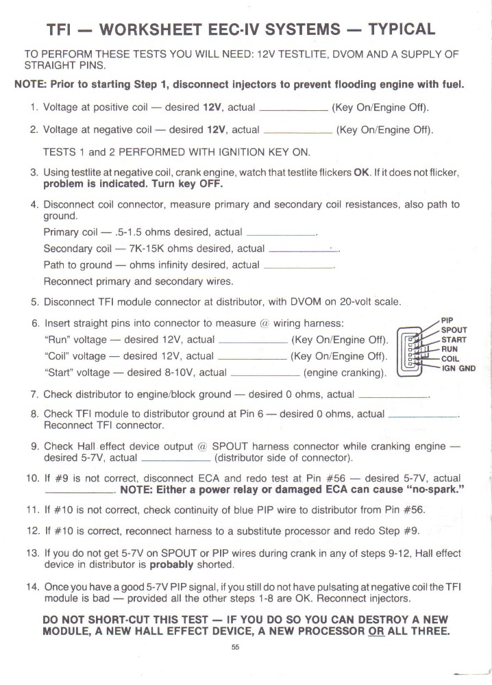

I’m working on a 1991 Ford F150 5.8 Engine code 212 (no Tachometer input to process spout) it starts runs then dies running time very . It will start back only if u turn the key to off .if u try it with out tuning the key off u have no spark

Follow this sheet

Thank u for working sheet I have measure all of this and all comes out good

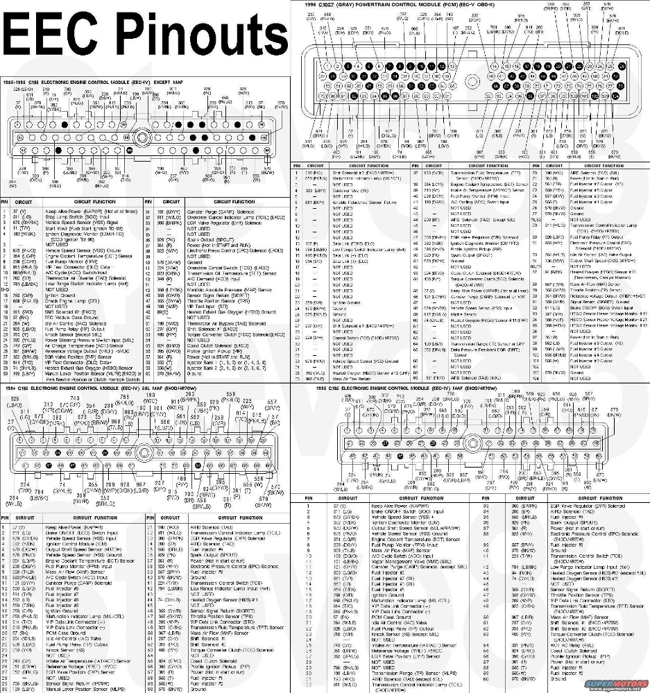

Does fuel pump run When you turn key to run position? What is the fuel pressure reading? Odds are either the three capacitors on the pcm have leaked on com board or pump is bad but also check fuel pump relay to see if it works like it should. With the pcm it's located in the drivers side side panel by the foot well connector is located on engine side of firewall and behind wheelwell pull cover off and check the capacitors to see if they leaked. if so a pcm is in your future.
