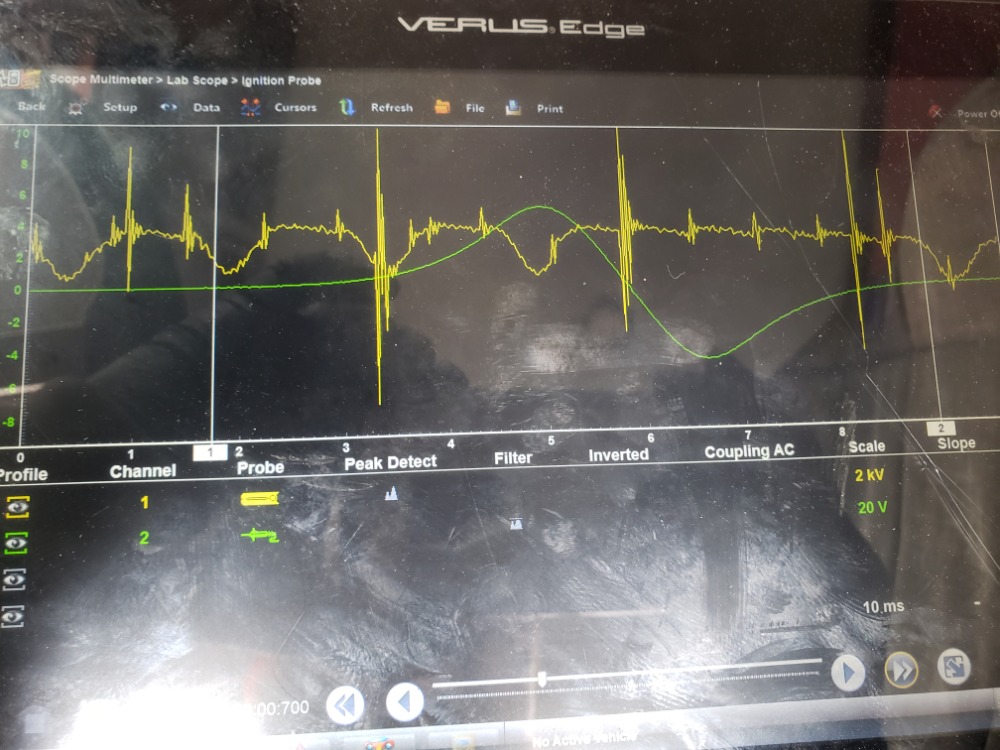

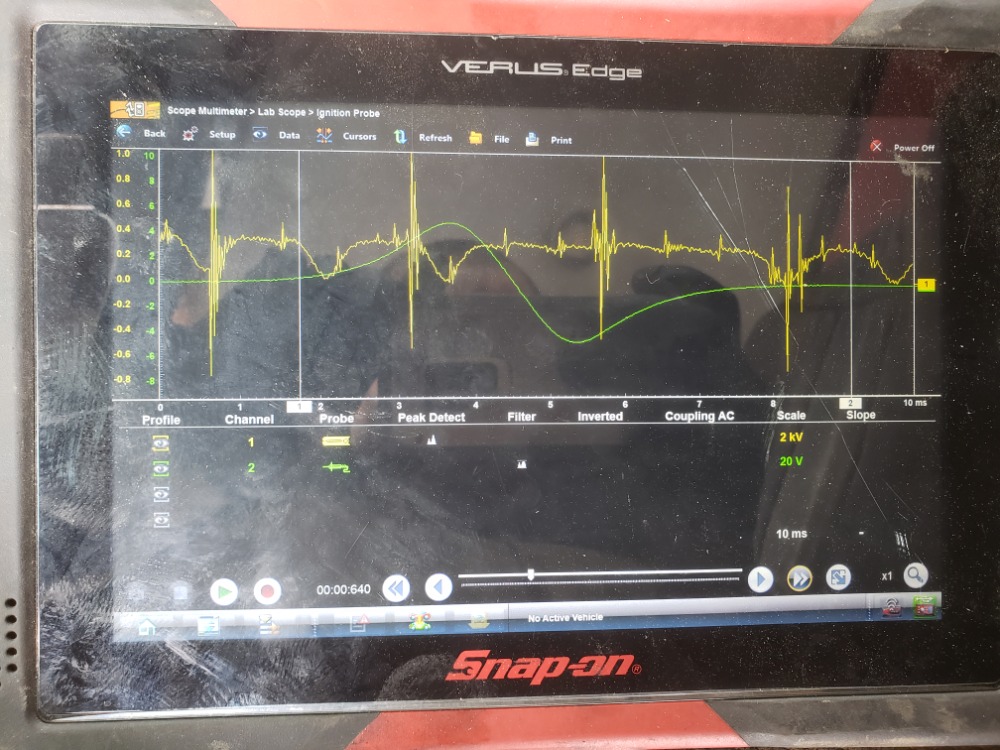

I need some guidance reading cam and crank relation. Sid 21 fmi 2 any help would be awesome. This truck is stressing me out.

First off what are you probing on each channel in pic? test power and grounds for sensors and resistance check wires to pcm. Might be bad cam sensor but nice munching on wires happens too just follow them back to pcm to see if melted etc.
