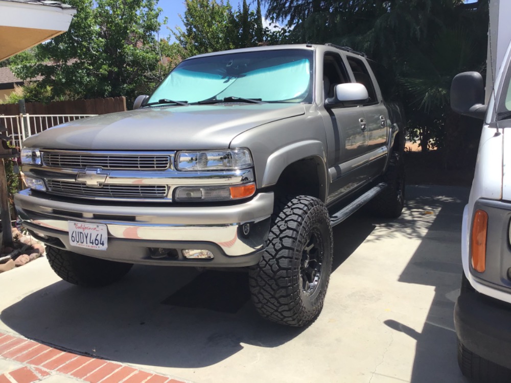

6 years 5 months ago #40082
Replied by Noah on topic 2001 Suburban 5.3 ..p0300 ..random misfire on cylinders 7 and 8 ..
That's a fine looking 'burb
