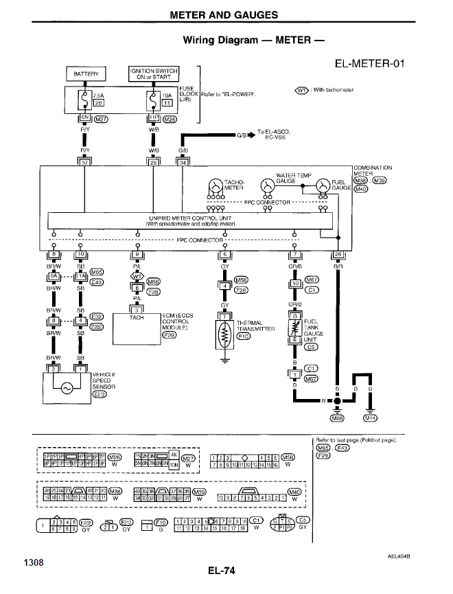

I agree with John on intermittent short to ground which gets disturbed when the sensor is unplugged being a possibility. Wiggle test with the sensor connected and an assistant watching the gauge will probably find that.
I'm guessing this gauge is a simple voltage divider circuit with R1 in the cluster and R2 being the temp sensor, with the gauge measuring the voltage between R1 and R2. So the less likely, but does fit the symptoms, cause is an intermittent high resistance on the R1 side. When R1 increases R2 will pull the voltage down and when R2 is unplugged the gauge sees full voltage. If that is what's happening I can't think of an easy way to diag it conclusively....

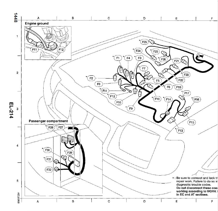

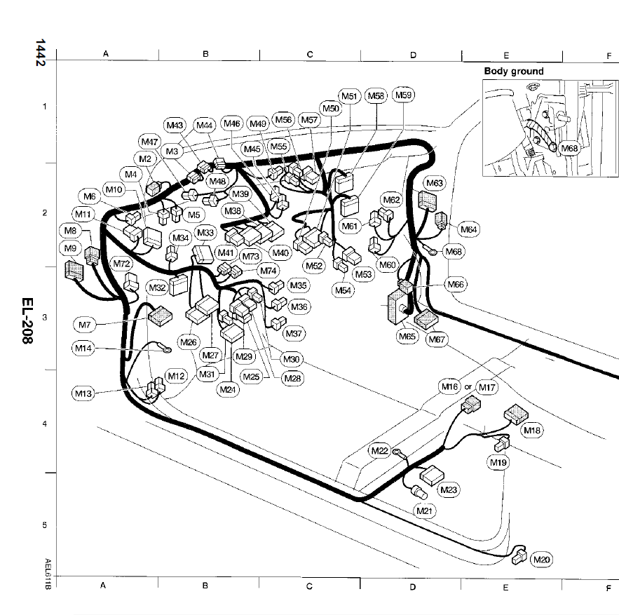

Because this is not going to be an easy one I downloaded the actual 98 Frontier manual from Nicoclub. Here are the actual diagrams for this truck. I think my attention would be at the harness and the connectors. Looks like there is a connector inside the cab, over on the passenger side under the dash. Maybe it's got some water or corrosion in it? Just trying to come up with something we've missed. You're close on this one, just need to get a few more checks in while it's acting up. The intermittent nature of it can make it difficult.

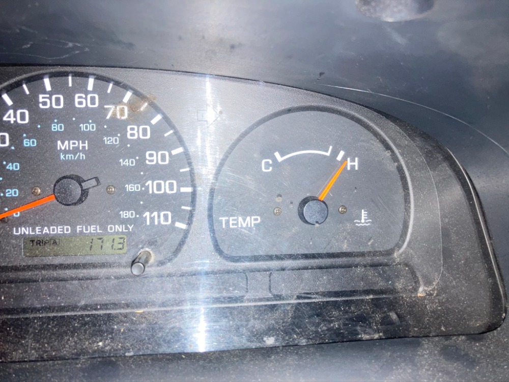

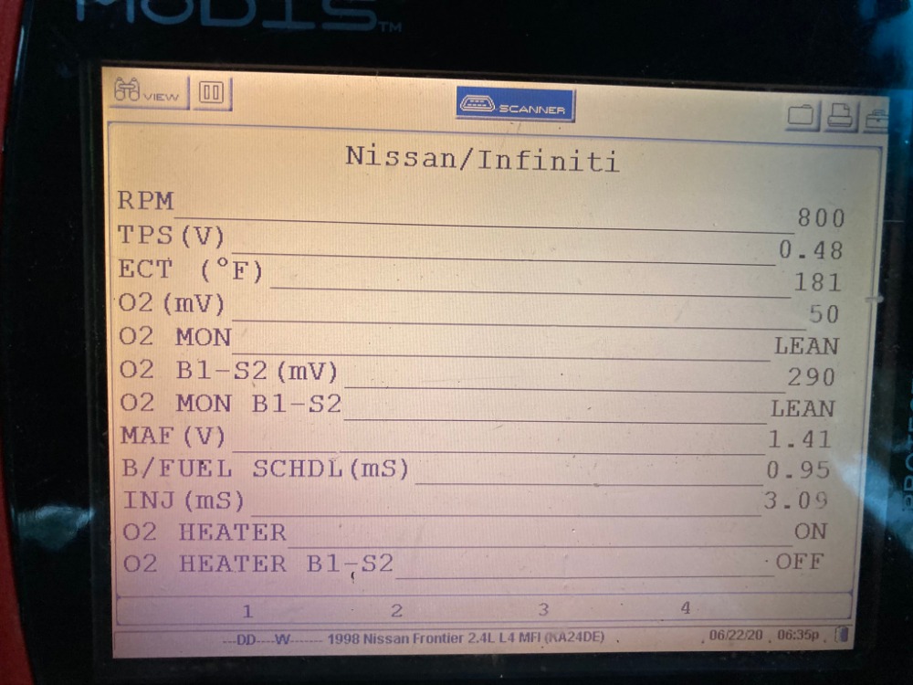

6 years 4 months ago - 6 years 4 months ago #40854 by JimT
So, put the scan tool on it and read the Engine sensor. It never moved off of 181 degrees F. While it unwaveringly sat on 181 degrees, the gauge read full hot, then after a while returned to normal. Conclusion? Pretty sure the truck is telling me it's not hot.
It's the gauge, right? That makes sense, but here's what I don't understand... while the gauge read hot, I ohmed that sensor. It read 47 ohms. That is low resistance and a reading that I would expect the gauge to register as hot. Why is the sensor reading such a value? I check the resistance by putting the positive lead on the sensor and the negative lead on the battery negative.
Pics of the scan tool and gauge are below.

6 years 4 months ago #40855 by JimT
Gauge while scan tool at 181
6 years 4 months ago #40858 by John Clark
Replied by John Clark on topic 1998 Nissan Frontier with KA24DE -- Temp Gauge
47 ohms shouldn't read full hot. That's about 212F which is getting pretty warm but not full hot, I wouldn't think.
It is looking more like an issue in the gauge circuit itself, likely in the cluster. Have you tried tapping on the gauge cluster when it's reading full hot?

I don't suppose you checked your two grounds for the dash m14, m68 have you? One is on drivers side front footwell the other is on the pass side door jamb under dash in your diagrams. These two spots can develop corrosion from windshield leaks etc. Would not hurt to check those for the green monster. Take them off and clean them as those are the cluster grounds from the guages.
