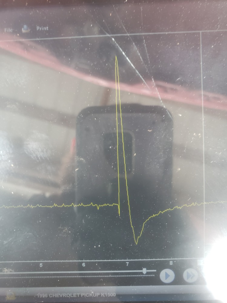

by Darrel
1996 chevy k1500 5.7 injector wave form help please was created by Darrel
Should I start checking power and ground at the at the pcm? Pcm behind the glove box? Looking for wiring diagram
6 years 5 months ago #40085
Replied by Tyler on topic 1996 chevy k1500 5.7 injector wave form help please
Did you happen to save that scope capture? Can you upload the .VSM file?
Without seeing the scaling of the scope, it's tough to say what's happening here.
Where is your scope connected?
- Darrel
- Posts: 9
6 years 5 months ago #40086
by Darrel
Replied by Darrel on topic 1996 chevy k1500 5.7 injector wave form help please
I'll get back to you on that

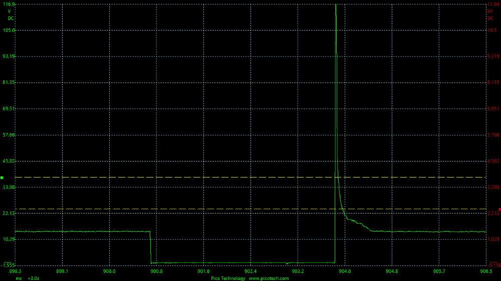

- John Curtis
- Posts: 345
- Thank you received: 111
6 years 5 months ago - 6 years 5 months ago #40094
by John Curtis
Replied by John Curtis on topic 1996 chevy k1500 5.7 injector wave form help please
A current waveform would be a huge help here in identifying if it’s a power/ground issue. Also, here is a capture of a good injector circuit. Notice how during the dwell is pulled pretty close to ground. That’s the indicator I’d be looking for on a voltage waveform.
As far as power, you can see it at steady battery voltage. But you can also provide your own power via fuses jumper wire to rule it out.
I’d really stress using a current waveform here as it’ll be tell tell of a computer driver issue and even power/ground issue.
