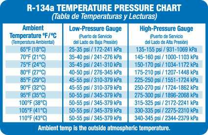

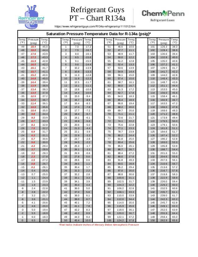

Here is a pressure temperature chart for reference

If he's looking for a leak, what's he going to do with a pressure/temp chart?
I have seen compressor case leaks that passed a vacuum leak test but would leak under pressure. The compressor shaft seal can do the same thing and leak worse when spinning. The other common place for leaks that seem to happen more when running is the condenser.

He was mentioning that after it sat for 36 hours that pressures matched ambient temp and with it being static pressure that is about right. Though my fat thumb clicked wrong image lol here is the right one for static pressure

Those charts are a rough guess, at best. During charging, I've seen the proper static pressures in the system with as little as 1/4-1/3 of the requisite charge. When you add the rest it doesn't change the static pressure very much. So, you can be as much as 1/2-3/4 low on charge and the static pressure will look normal. It just tells you there's enough for the compressor to turn on, at least for a brief time.
I think he's just comparing that to a day of driving it where all the refrigerant leaked out in a day.
