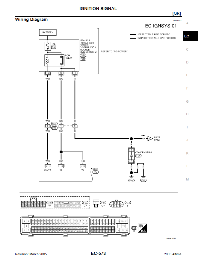

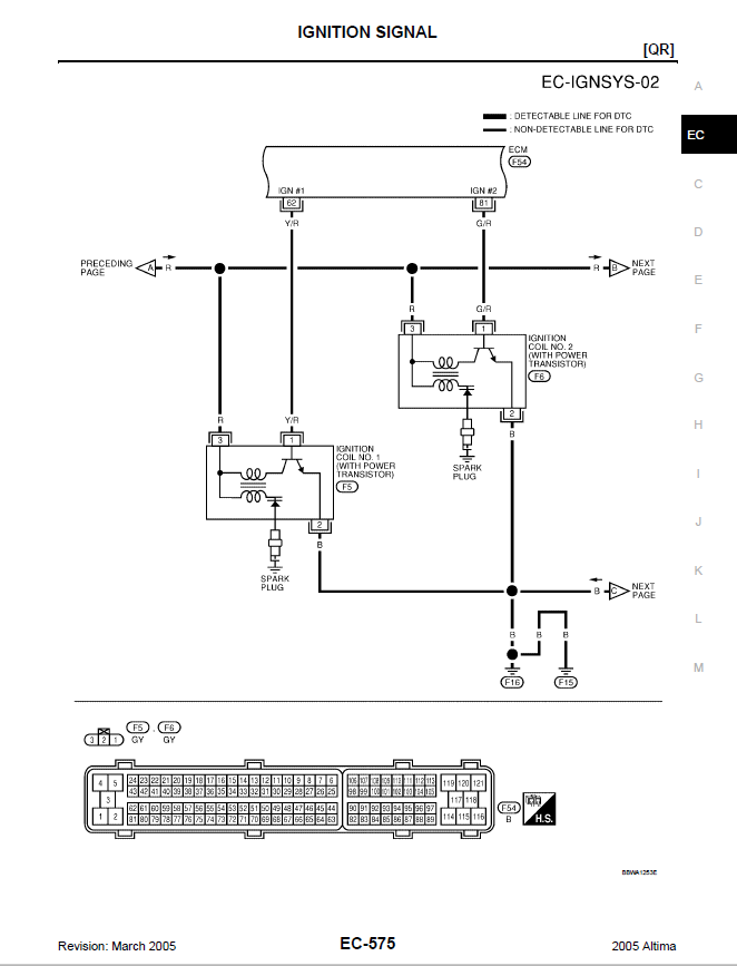

bought this car cranks/wont run. they also stole all ign coils. I put all new denso coils in and new NGk's immediately upon cranking Ign coils 1 & 3 got real hot(still not running btw) no codes except P0300. so I compared the signal wires to coil from ecm and 2 & 4 have about .7-.8v bias koeo. but # 1 & 3 have about 2.8v and 3.2v respectively, so it seems coils are staying on (according to diagram this is a power feed signal driver to coils (not ground side driver). so I pulled ecm and checked cont. for all signal pins to coils (pins-61, 62, 80 and 81, all ok and none are shorted to each other or powers/grounds. Im ready to call the ECM drivers for #1 and #3 as shorted, those coils wont shut off, please tell me I'm wrong.. thanks a ton.

Do the good coils fire normally when cranking? Do you have a scope to watch the signal wires on a known good and then on the suspected bad? Also it would be handy to check the current ramps while cranking, as well. I found a service manual on nicoclub and thought I'd post a screen shot of it so others could help you better. Just looking at the diagram, and by what you describe, it does sound like the ECM is keeping them powered.

John I have the exact diagram, I do not have a scope, but the other coils are not firing either, plus there are no codes in vehicles at all. I could pick up a scrap yard ecm but I dont have a programmer. so we will see what happens, thanks.
