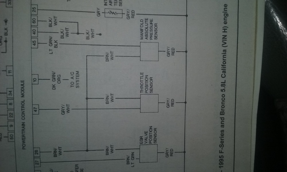

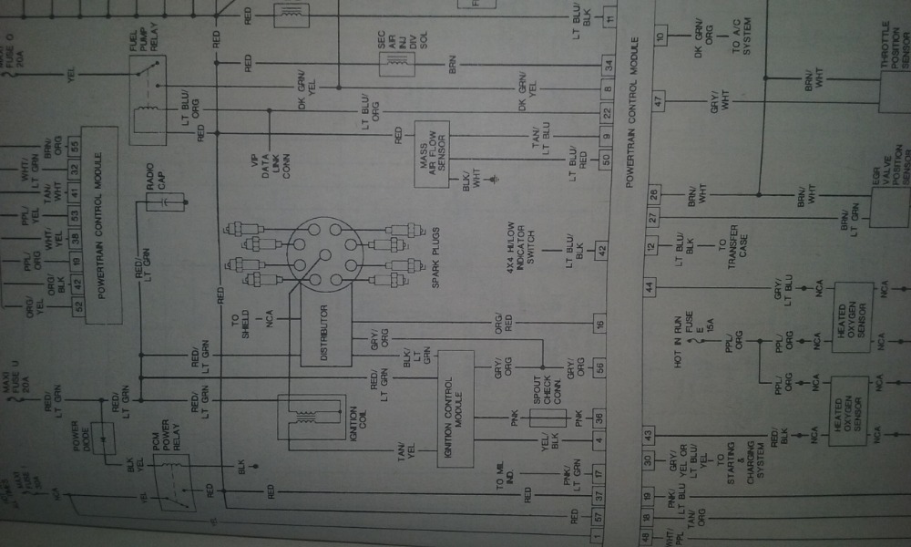

Here is the images from my book and where they go to the ecm.
For the tps sensor
Brown/ white wire 5 volt ref from pin 26 @ ecm (this should have 5 volts all the time with key on)
Grey/white tps signal to pin 47 @ ecm (this voltage with key on throttle closed should be .9-1.1 volts)
Grey/red sensor ground pin 46 @ ecm ( .3 volts or less cranking)
Please note the colors listed is the wiring harness colors not the tps sensor wires coming from connector to tps.

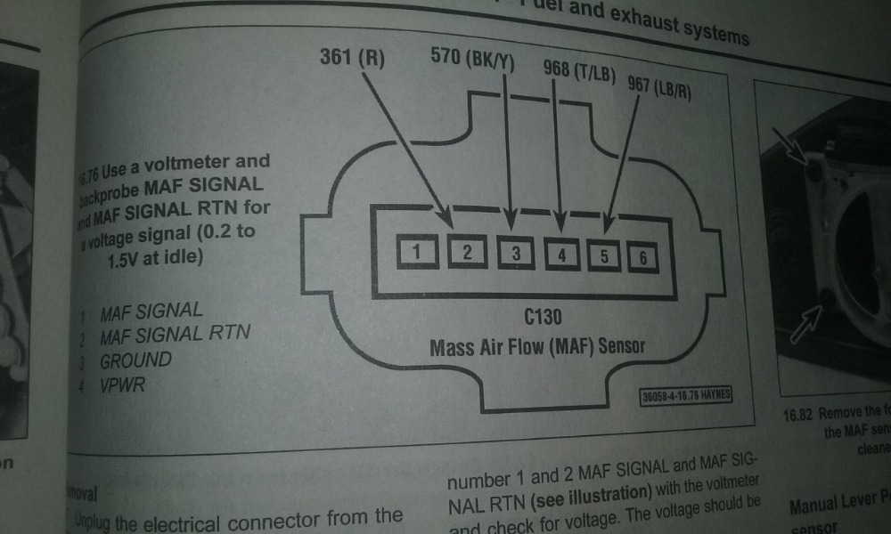

Also included the maf sensor image as well
Red wire 12 volt power feed (fed power via ecm /pcm power relay spliced into pins 57 & 37 of pcm/ecm pin 2 @maf is 12 volt power
Tan/light blue pin 9 @ ecm pin 4 signal return
Light blue/red pin 50 @ ecm pin 5 @ maf signal
Black/ white pin 3 @ maf ground wire grounded near sensor
The two outer pinholes on your connector should be empty
For the tps sensor
