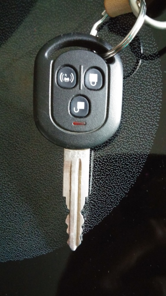

6 years 5 months ago #40225 by Mags2011
I recently purchased a 2011 Chev Aveo 5 and purchaser had only one key to go with it .... so I went to my GM Dealer for another key ( had to take car in to be programmed !) After 3 hours and $ 250. later GM couldnt pull the key code !!! So I have the $130.00 transponder head key which they say cannot be programmed to my Aveo 5 .
If I put it in the ignition it will lock up the car!.. The new key is cut but I cannot use it.
Can anyone please offer a solution to my big problem?
Is there a way to bypass the key code ??
Thanks
Mags2011
  • juergen.scholl
  • juergen.scholl's Avatar
  • Active partschanger
6 years 5 months ago #40230 by juergen.scholl
The immobilizer function can be turned off in the engine control module. This is done by altering the information in the eeprom. You should look for a qualified locksmith, not really a big deal.
Does your car feature a delphi mt 80 ecm with 2 connectors, grey and black?
