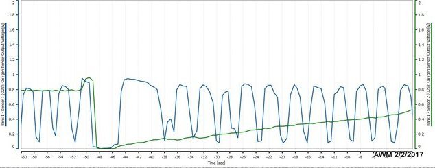

9 years 8 months ago #5448 by Andy.MacFadyen
Replied by Andy.MacFadyen on topic P0172 code 2001 focus
B1S1 0.500v ---- that looks like the PCM is using a substituted value for the pre-cat O2 B1S1 sensor.
The pre-cat O2 sensor is a good place to start the investigation. As the problem started after a block ground cable failure I would start by checking the sensor heater power, heater ground and sensor ground.
From a cold start the sensor output voltage on both B1S1 and B1S2 should initially flatline low then as the engine warms up first B1S1 then B1S2 should come to life.

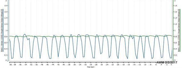

9 years 8 months ago - 9 years 8 months ago #5459 by Andy.MacFadyen
I suspect the sensor isn't actually reading 0.5v from B1S1 but the PCM is not reading the sensor but substituting a default value.
On Hot Idle B1S1 and B2S2 when running closed loop should look like this. B1S1 is continuously switching hi-lo-hi-lo adjusting the fueling around the ideal air-fuel ratio. When the fueling is correct and the cat is working properly B1S2 should always show a high voltage at idle as all the O2 in the exhaust is used by the catalysts.
Then snap throttle B1S1 and B1S2 both go rich then dip lean then B1S1 should quickly recover back to normal closed loop hi-lo-hi-lo.
B1S2 recovers more slowly.

The obd2 scanner I am using fluctuates pretty fast. On the o2s b1s1 ranges from 0.025- 0.815 on first test and 0.025- 0.500 second test which is why I wrote down the last number. I will check these while I do snap throttle response test and vacuum leak test. Thanks for the help I will repost results tomorrow.
9 years 8 months ago - 9 years 8 months ago #5466 by Andy.MacFadyen
The fluctuating B1S1 voltage suggests that you have a a true rich condition that is being trimmed out. What conditions was the car operating under when the live data was taken ? as 40% calculated load at 710rpm seems too high. The airflow reported by the MAF which my maths {edit now corrected ! } converts to roughly 3.0 grams/second seems too OK for a 2 litre gasoline engine at 750 rpm idle. The problem is I don't know the normal MAF reading for this engine and I would also suggest checking the sensor powers and grounds first especially as the car had a block ground problem which may have overloaded other ground circuits.
