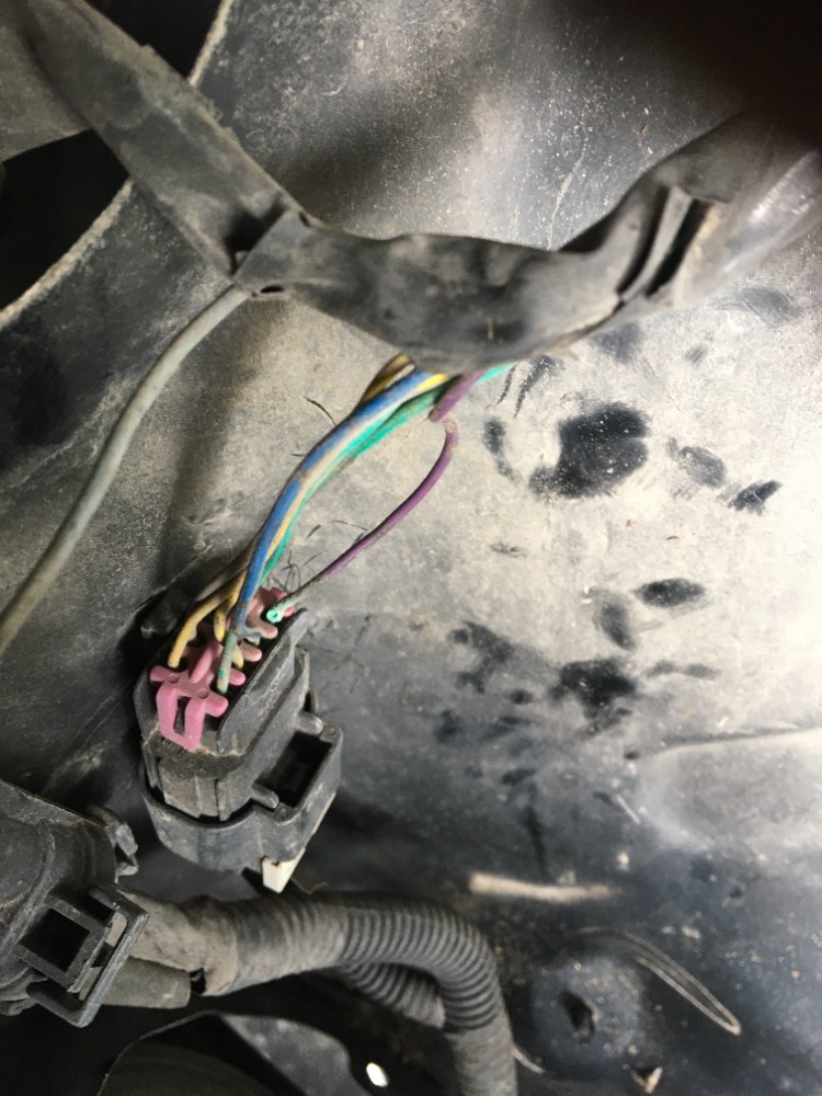

This is my personal vehicle. I have had it a year and a half. DRLs have never worked since I have owned it. Outer bulbs were out (the ones used for DRL) I replaced all 4 bulbs. Turn signals all work now, parking lights all work. No more bulb codes. DRL indicator in cluster comes onwhen you put it in gear, etc, but BCM does not turn on DRL. AHL works. I can command the DRLs on with my Solus Edge. Anyone have any ideas?

I was playing with the truck tonight. While I had the DRLs commanded on, I pulled the DRL fuse. To my surprise, the DRLs stayed on. I also pulled the DRL relay, and the DRLs stayed on (commanded on by scan tool). Next I grounded the relay.(DRL not commanded on with scanner) The low beam headlights came on. I know early 2006 had parking light DRLs, and sometime during the model year they used low beams for DRL. This truck has a build date of 3/06. I'm confused at this point.

The pinouts on the BCM and the electrical center don't show any means to activate the DRL relay.
If all else fails, I am thinking about just running a wire to activate the relay with a switch. This would give me headlight DRLs. Not really first choice, but better than not having working DRLs.

Update: Still not fixed, but I have learned some things. This truck, by VIN breakpoint should have headlight DRLs. Also, my Snap-on scanner DRL output test is useless on this truck, as it turns on the parking lights, instead of turning on the DRL relay. I have a 2007 wiring diagram that shows the DRL wire as a ppl wire @ pin a36 at the bcm. I need to pull down bcm to see if the late production 2006 is in the same location.

FIXED!
I got a hold of a 2007 wiring diagram. It showed a purple wire (ckt 455) a36 at bcm, b5 at electrical center. I found a connector (c104) under the air breather with a crusty purple wire. I grounded the wire going back to the electrical center, and DRLs came on. Wired around the connector as a temp repair until I find a terminal with a stub wire that fits that connector.
