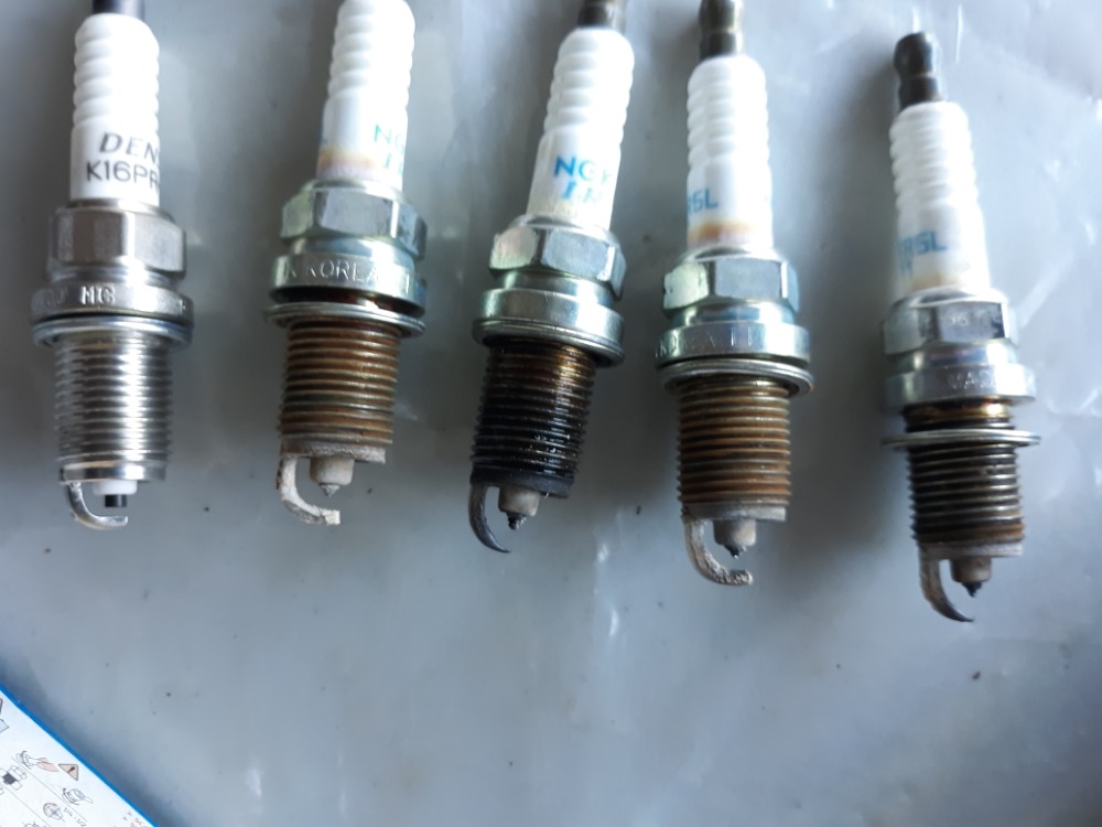

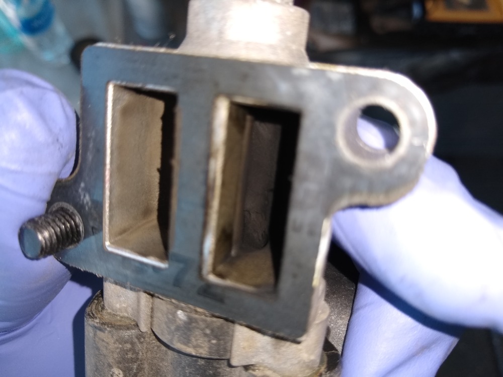

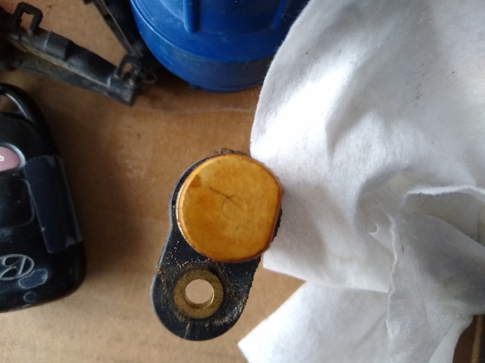

I'm reaching out because I'm stuck... My name is Vince, been a diesel mechanic for 15 years. I'm trying to help my brother in-law out with his car. It's a 2007 Hyundai Elantra 2.0L, with 213,132 miles. So the complaint is when he leaves work he drives 25 freeway miles home, as soon as he gets off at our exit, he comes to a stop and the car dies. So it usually happens when its hot, A/C on, in gear and only during the day (I know the problem isn't Photo Sensitive related .0)). I have tried driving evening and night and cannot duplicate the symptom which doesn't make sense. Today is about 103 degrees outside "Green Valley Az". Originally he thought it was spark plugs which I changed for him which I will include pictures. As you can see I thought the problem was plugs as well. I replaced the Idle air control valve Due to carbon build up and the gate inside was sticking... I have many days trouble shooting this car... I found the crank sensor with a hair line crack so installed a new one. Truth be told I thought that I fixed it until just a moment ago when I received a message saying the car died again. So fuel pressure is a 50 psi and holds strong. I have been using the torque pro app with a blutooth adapter, if that is wrong please tell me so... Any help or direction I would be so grateful for.... Thank you...

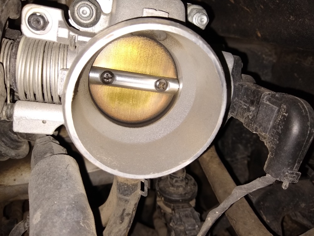

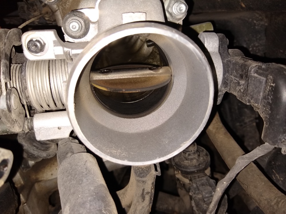

Could be as simple as the Idle Control Air Valve and/or throttlebody needs cleaned. I have seen this cause similar issues on smaller engined cars stalling at junctions as the AC, power steering and electric loads are relatively large compared to the engine power at idle.
Last edit: 6 years 4 months ago by Andy.MacFadyen.
6 years 4 months ago #40454
Replied by Noah on topic 2007 Hyundai Elantra 2.0L Stalls when hot outside, and A/C on...
+1 for throttle body cleaning

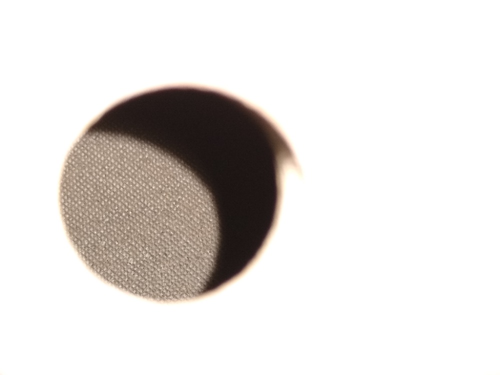

Okay, so I will include more pics. I have cleaned the throttle body with brush, rag, and cleaner, I cleaned the IAC port in the intake and installed a new IAC valve. Cleaned positive and negative battery terminals and cables. Checked fuel pressure. No codes whats so ever (I did check before I disconnected the battery, and after multiple test drives). I removed MAS (it is the grid style, not resistor style) and cleaned intake tube out (had some dust in it). I blew off MAS sensors and Temp sensor with a can of office compressed air. That upstream CAT looks in good shape, I took some pictures when I had the upstream o2 out. Like I said I'm using the torque pro app (I dont have a diagnostic scanner), a couple things that boggle me. ... First, it says the "Air Temp" is 68 degrees (when its like 85)but I dont think that will affect it. Second the Upstream o2 (o1s1) shows no data until the car is actually driven at road speed (it is a 5 wire sensor, I have never seen an o2 behave like this). I installed a new o2 sensor and it still behaved as such. Last thing is when the car does start Idling rough, I hear the all four injectors start clattering loudly. I thought it might be the fuel damper on the fuel rail but with the fuel gauge mesuring the fuel rail pressure it is a constant 50 Psi with no pulsation characteristics... Pictures are of old IAC, before the throttle body cleaning, a look at the upstream CAT. Truth be told the car Idles better with either the IAC unplugged or the MAS unpluged....
