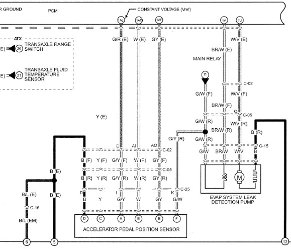

10 years 3 months ago #526 by Tyler
Replied by Tyler on topic mazda axela or mazda 3 2.0 jy 37 engine
Dylan wrote: I hope Tyler or Noah do. Could you also mention the year? Thx
Why'd you mention me? It's not like I post wiring diagrams ALL the time! lol
Actually, I found one, but it honestly kinda sucks:
We can't even see where the yellow wire goes! I *think* it's supposed to be a sensor ground, but don't quote me there.

10 years 3 months ago - 10 years 3 months ago #588 by Noah
Replied by Noah on topic mazda axela or mazda 3 2.0 jy 37 engine
Attachment not found
Looks like from left to right:
Ground
Sensor Ground
5v ref
Position signal ( 1 or 2)
Position signal (1 or 2)
Battery +
So not quite what I was thinking to begin with. Hope this helps you.

10 years 3 months ago #589 by Tyler
I actually liked what you were thinking the first time, as that's what I usually expect with an APP sensor. Mazda just had to be different, I guess?
