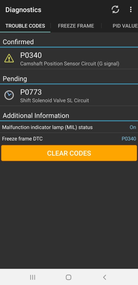

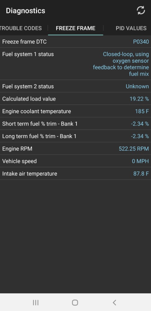

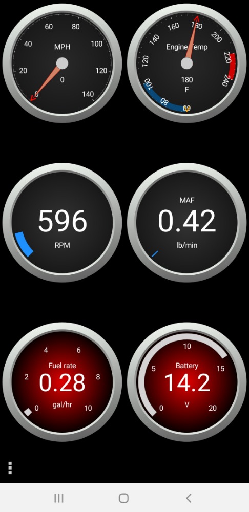

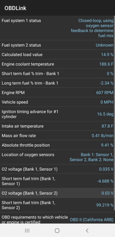

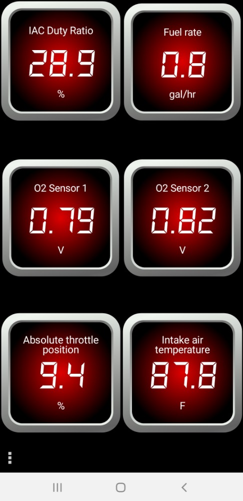

Here is some info from the scanner, ignore the p0340, and the trans code. The p0340 was a bad pin on the ecu. I have fixed that and is no longer an issue. The trans code is there because this is a swap into a manual trans 4runner, defeating the codes with a reistor and the sensors makes that code go away, so no issue there either.
Every now and then you can hear the engine blip up and it will suddenly rise to 630 rpms or so before it studders back down. Now and then you can hear a blip blip blip, sounds just like a small missfire.
Cam and crank signals look good, all injector signals look good, all have pintle movement. Secondary ignition signals looked good from what i could tell. At idle it was kindof hard to see since the wave kept jumping back and forth horizontally at idle, but i could get it to display a somewhat steady signal at anything other than at idle. I could also only test one side of each cop since there are only 3 wires for 2,4, and 6. 1,3, and 5 are cops.
The blip up in rpms tells me something is definitely wrong, and when it blips up suddenly, whatever the problem is must intermittently go away for a split second.
Thanks for your replies!

Unfortunately not yet. Ive checked all my wiring at least 5 times, all thats good as far as visual inspection/function. Ive read the crank waveforms and cam waveforms, both look normal, i have not looked at them at the same time though, but since i have good compression all the way around im confident that my valve timing is correct, ive verified that its correct visually as well.
I did notice the other night that that it seems like it might have something to do with fuel trims. The ecu was fresh, no stored information, it was just sitting idling and the idle blipped while i was watching the fuel trims, and at that moment was when the long term fuel trim adjusted more negative.
Long term fuel trim tends to hang out at -7.6 ish while idling and 0 at 2k rpms. Short term fuel trims seems normal bouncing from -3 to +3. O² sensor voltages fluctuate as well. My O² sensors only have about 3k on them.
Not sure whats causing the negative long term, seems like it could just be the charcoal canister purging.
I have not checked hot resistance of the iac, maybe it only fails hot. I do get a signal on both rso and rsc pins which is normal, the duty cycle goes down as it warms up and is steady, flicking the throttle increases duty cycle a little bit but then returns to the previous lower on time.
I have also not checked fuel pressure, its possible that my fuel pressure regulator might not be working correctly, thus causing the slightly rich condition at idle. The FPR does not show any obvious signs of failure.
All of the injector waveforms looked good too, pintle movement and all, i have checked injectors out of the vehicle and they did not leak. So Im sure they are all good.
Only 2 things it seems it could be is a bad iac, or high fuel pressure.
Sometimes while its just idling it sounds like it will misfire a blip or two, and sometimes it seems like it wants to idle normal for about 2 seconds.
