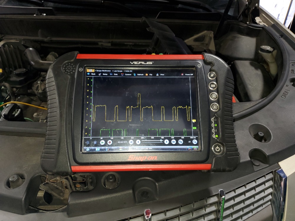

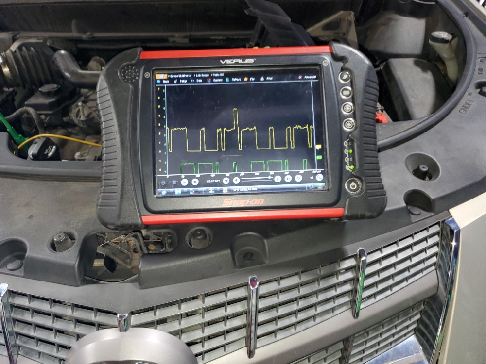

2010 cadillac srx p0017
- Betterway52
- Posts: 17
6 years 4 months ago #40592
by Betterway52
2010 cadillac srx p0017 was created by Betterway52
took a capture of the exhaust solenoid bank 1 and looks like this. Whats does that look like?
- Hardtopdr2
- Posts: 853
- Thank you received: 150
6 years 4 months ago #40594
by Hardtopdr2
Replied by Hardtopdr2 on topic 2010 cadillac srx p0017
Looks like solinoid is shorting to voltage or shorting internally. Swap solinoid out with other bank and if it follows you will know if it is the solinoid. otherwise wiring will need checked

6 years 4 months ago - 6 years 4 months ago #40608
by Hardtopdr2
Its a possibility as well but doubtful as voltage climbed above the waveform. If timing was off one wave form would be shifted one way or the other(left or right). I would say to compare it to a known good waveform to verify if that happened.

- Betterway52
- Posts: 17
6 years 4 months ago #40610
by Betterway52
Replied by Betterway52 on topic 2010 cadillac srx p0017
Could not find a known good waveform. However the green trace in video which you can't see was normal looking with no dips. Going to swap sensors and see what the good looking one looks like on the exhaust side.
