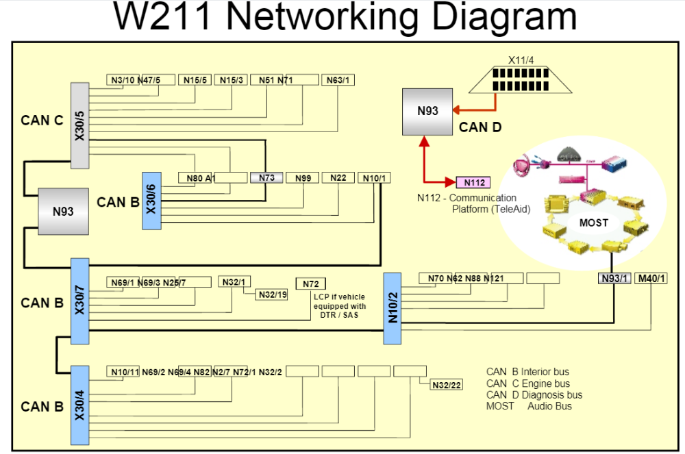

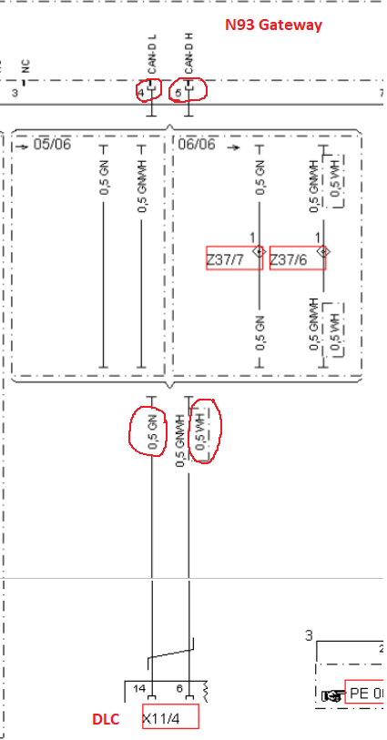

Im not really getting smarter. I have attached a diagram(zip file) over the N93 (gateway module) which connects to X11/4 (DLC). Gateway talks to all modules.
I could lift the strip connector and measure (volt) each metal strip on the CAN distributor, And remove interconnect plug between the CAN distributors and at same time checking voltages on metal strips.
Last edit: 6 years 3 months ago by larsk84.

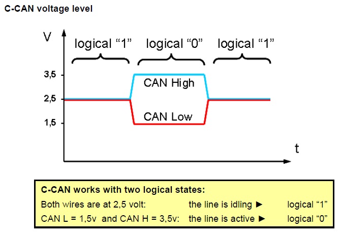

6 years 3 months ago #41200 by tech25
Replied by tech25 on topic Low CAN voltage Mercedes e550 w211 -06
Hello, please lets start fresh. with all modules connected in the vehicle. ( stock ) please disconnect the battery negative terminal.
Measure resistance across pin 6 and 14, should be around 60 ohms plus or minus 10%
then measure from pin 6 to ground, and 14 to ground, you should have more than 500 ohms.
reconnect negative battery terminal.
turn meter on dc volts and measure voltage at pin 6 and ground
and measure voltage at pin 14 and ground.
voltage will change depending upon if the network is asleep or awake. please refer to this picture and compare voltages

theoretically, shouldn't I get the same low readings if I measure directly on the Gateway. If so the gateway must be faulty I quess. I checked yesterday and I had constant 12v going in on N93

I fixed the issue now. To my gatewat there is two connectors. One connector is to the GPS unit. I removed this connection and I got 2.5 V idle on each CAN-L and CAN-H. And with ignition on - there was 3.5 V and 1.5 V. I manage to connect my scanner now.
