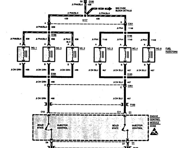

Feel like I am chasing my tail hopefully you guys can give me some insight.
1994 Cavalier 3.1L
I have spark and fuel pressure at the rail, I also checked for codes and there were none besides code 12 which just tells me it's in service mode from what i've read. I pulled the upper intake manifold and ohm'd out all 6 injectors and all are at 11.8 ohm. I checked voltages at the connectors and have 12v and 5v at all 6 injector connectors.
Now I know these GM 3.1s have injector shorting issues but showing about 12 ohms of resistance doesn't tell me they are shorted, correct? I have poked around on the internet for some help with no luck.

I really like the testing you've done so far. You're clearly getting power to the injectors, but we need to know about the ground control from the PCM. I know most of the injectors are covered by the intake on this one, so we'll have to get to the control wires at a different location.
Here's the injector diagram, for reference:
I'd be interested to know if the dark blue and dark green wires will pulse a test light (connected to B+) at C351, or at the ECM, if that's easier. If the test light pulses, then we know the injector driver is working. If not, then we may still be dealing with shorted injectors.
Not completely. :( It's a good static measurement, but it doesn't prove that they're not drawing too much current with an electrical load applied.
If you get no pulsing of the test light at those two control wires, then I'd suggest disconnecting C351 and rechecking. With the injectors out of the picture, the ECM should easily be able to pulse a test light on both wires. Does this make sense?

Yes, that definitely makes sense. I'll grab my test light and try testing from both locations, C351 and the ECU. I will get post back as soon as I can get the results.

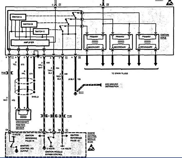

I like Tylers suggestion. Do that. Then also check the purple/white reference wire from the ICM (ignition control module). This is your RPM reference signal. The crank sensor feeds an AC sign wave into the ICM and the ICM converts it to a 0/5v square wave that is send to the ECM for injection control (and timing). It is common for the ICM to fail and not deliver this signal. It is weird to say your ICM can be faulty with good spark, but it happens often on this design.
If there is no signal there, we are not worried about the crank signal because you have spark, and we are not worried about the ICM power and ground circuits either (because you have spark). It would be a faulty ICM. Confirm injection pulse by turning the key on and take a test light to battery positive and touch on/off the purple/white reference wire, which will make the ECM fire the injectors.

I had no pulse to the injectors or from the ecu. I checked the purple/white wire as suggested, the purple/white does run from the ICM to the ECU correct? If so I found a tested the purple/white wire at the ECU. The location of the ICM is awful for testing. During cranking the test light did not light. (Only reason I ask if that is correct is because when I turned the key on for a second the test light lit then went out and then would not light during cranking). It was the only purple/white wire I found at the ECU location. So if I tested correctly I then it showing that the ICM is not sending a signal to the ECU for injection pulse.

About the ICM and the purple/white wire, there may have been some misunderstanding. :unsure: We really weren't looking for the test light to light on the purple/white wire, as much as use the test light to simulate the ICM's signal to the ECM. I dunno why the light lit up at all, to be honest. :blink:
For reference, here's the ICM wiring diagram:
I'm not sure if it's the ONLY purple/white at the ECM, but it should have a black/white and a red/black next to it on the same connector.
