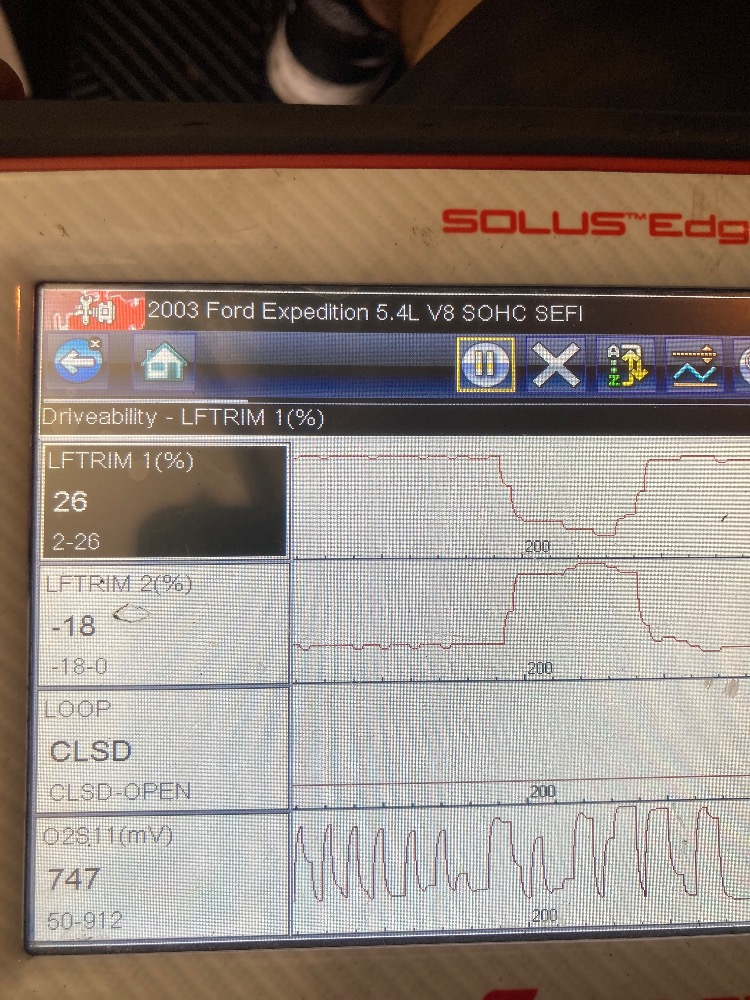

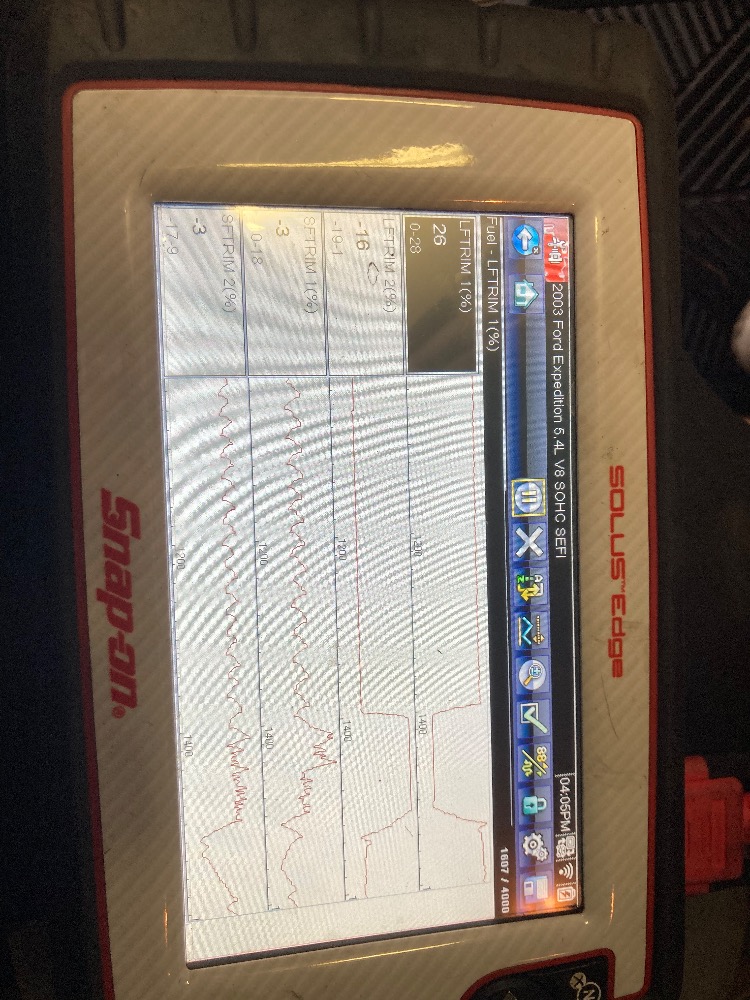

Smoke tested already I couldn’t find any leaks other than the idle air control valve which has been replaced new iac still seems to have smoke coming from it I’m guessing it’s normal and swapped both 02 sensors from bank to bank still no change

Also put a vacuum guage to it got 20inhg and pinched off brake booster
And used a known good maf still no change in fuel trims

Possibly a restricted cat because one bank is lean and one is rich. Have you checked fuel injector flow rates bank to bank

I did an injector balance test all of them drop 13 to 15 psi each

Did you check for an exhaust restriction?? With one bank rich and one lean I’d suspect it

I did a vacuum test since I don’t have a back pressure tester it had 21inhg of vacuum at 2500 rpm

Any TSBs? How’s it drive low on power??
