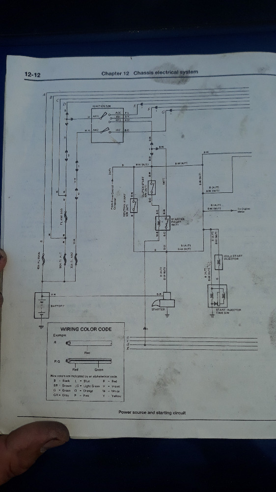

Hello Everyone,
I have a 91 toyota camry 2.0 automatic transmission, I have changed the plugs, distributor cap, wires, fuel filter, fuel pump and a bunch of other brake system and suspension related parts to get it safe for my son. I have also put a new battery in and changed all the fluids, along with a oil filter, I had got the car working after not being used for 2 1/2 years, all I had to do is bleed the brakes, took the car out of the garage to work on my car (drove it out) with no issues, when I was done with my car I was going to put the car back in the garage but it did not want to crank. I have changed all the fusible links, I have tested the started and it tested good, I have tested power and ground from the battery to the starter successfully, I have tested power from the battery to the harness on the neutral safety switch successfully. I will be trying to test for power and ground at the ignition switch level soon. I do hear the relays clicking on the fuse block in the engine but do not have a single relay that is for the starter. To this point I am at a lost as to which direction to head, I'm thinking of checking for power and ground at the ignition switch level and if all is good there I am thinking of removing the neutral safety switch and cleaning it and giving that a try. Would anyone be able to provide any guidance on what else to check and what to look for? I am attaching the diagram that I am using to help me troubleshoot? Thank you in advance.
Thank You,
Javier Rivera
Diagram image:
Thank You,
Javier Rivera
Diagram image:
- Hardtopdr2
- Posts: 853
- Thank you received: 150
6 years 3 months ago - 6 years 3 months ago #41169
by Hardtopdr2
Replied by Hardtopdr2 on topic 91 toyota camry 2.0 was starting now no crank/no start
That part of diagram is for a manual transmission. The neutral saftey switch replaces the relay and clutch safety switch. So start at the n.s.s. or starter and work your way back through circuit.

You will need to find a pin out diagram for the n.s.s. and check power to starter wire when turning key to start position and power to ignition switch circuits. If n.s.s. is working you should see voltage going to starter solenoid. Provided it's getting power/signal from ignition and it senses it's in park or neutral. Have you tried starting it in neutral?

Ok is it sending power to starter solinoid?

Was it battery voltage? Or less than battery voltage?
Voltage at nss is what?
Voltage at starter solinoid is what?
