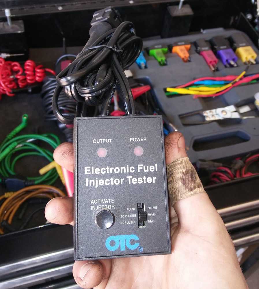

In my experience isolating the fuel rail and monitoring pressure drop is the surefire way of seeing a leaking injector. One would think that a leaking injector would also have different flow rates then a non leaking one, so using a tool such as this may also be a viable option in diagnosing it, but I haven't tried it on a leaking injector situation yet.
As for the method you used, it could be worth experimenting with further. One could speculate that disabling an injector has a unique effect on short term fuel trim immediately, and by comparing the fuel trim reaction of each injector it could highlight one that reacts dramatically differently. I like it! I'll have to give it a try on the next leaking injector problem I see, and I'll try and report my findings.

The tool on the photo is the right tool for the job.
As you say, i was comparing FT reaction for individual injectors. There was a clear difference and engine was running much nicer in terms of trim numbers and 02, with 2nd injector disconnected. Computer could not control the mixture. Without it it has adopted as much as it could to keep the lambda at 1.
I must mention that i had slight problems getting good readings. By disconnecting inj. you get a fault code and readings stop. The way i got around it; cleared the code, start the engine. It worked for me.

I'm sure to combat the problem of the engine entering a default loop status, etc. you could just rig a test light in series to substitute the load and avoid fault codes. The only thing I have used my injector timer on thus far is checking for restricted injectors, but I am keen to give it a whirl on a known leaking injector to see what results I collect.

This is the one I use. It was a cheap-o ($25 I think on Amazon).
The leads are short, and it didn't come with any adapters, but I clip injector connectors off junk engine harness and keep them in the case for when I need them.
I'm kind of curious to see if it would help ID a leaky injector or not. The problem injector would always be leaking, so whatever pressure loss is coming from that injector would be observed no matter which injector you were testing. Also, I think the results would be hard to interpret with the gauge needle constantly falling.
Or maybe I'm over thinking it
Replied by Noah on topic Running rich; leaky injector?
