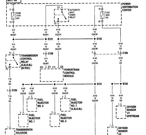

9 years 8 months ago #5755 by Tyler
Replied by Tyler on topic 1999 dodge ram
Does your 3500 have a 5.2 or a 5.9L? Just want to know for diagram purposes.
Yeah, the dog house will be too much work to take off at a moments notice... How about this? I did some digging, and I found the fuse that the ASD relay feeds to power the ignition coil, injectors, O2's and PCM. It's listed as fuse 19/20 in the Power Distribution Center. Here's a partial wiring diagram:
The next time the van acts up, jump out and check for power at this fuse during cranking. If there's no power, then we're going in the right direction with the ASD relay. If there IS power, then we need to go in a different direction.

9 years 8 months ago #5768 by laird
Replied by laird on topic 1999 dodge ram
It is a 5.9. I will try what you suggested next time it stalls.
