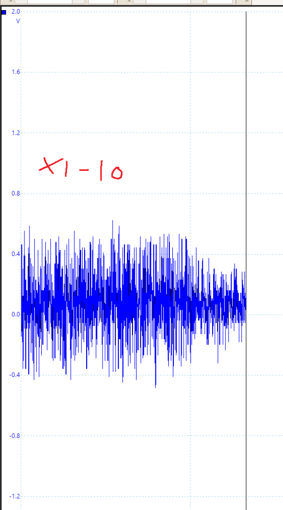

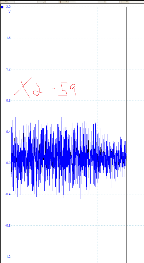

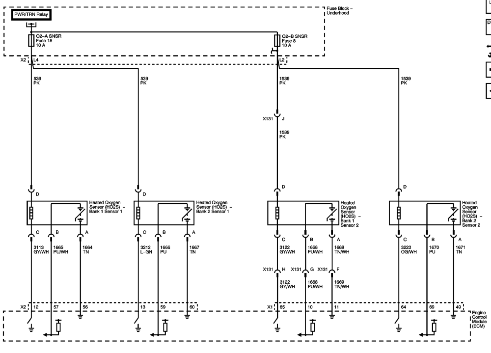

I decided to hook my picoscope 2205a to the O2 sensor signal at the ecm with a T-pin. I wanted to measure the drop and rise time of both sensor signals between 600 and 300mV to make sure it was lower than 100ms. Here's where I ran into an issue. All I got from (what I think is) the signal wire was noise. (Pin x2-59, right?) My scope ground was good and read battery positive and the heater control square wave (pin x2-13) just fine. I used my multimeter to make sure there was continuity between the t pin and the pin of the connector for each test. The tech 2 shows a sane-ish signal, so I know that I'm doing something wrong.

I went all the way down to about 50ms/div and up to 5sec/div while trying everything in between. The signal always looked like high frequency noise.

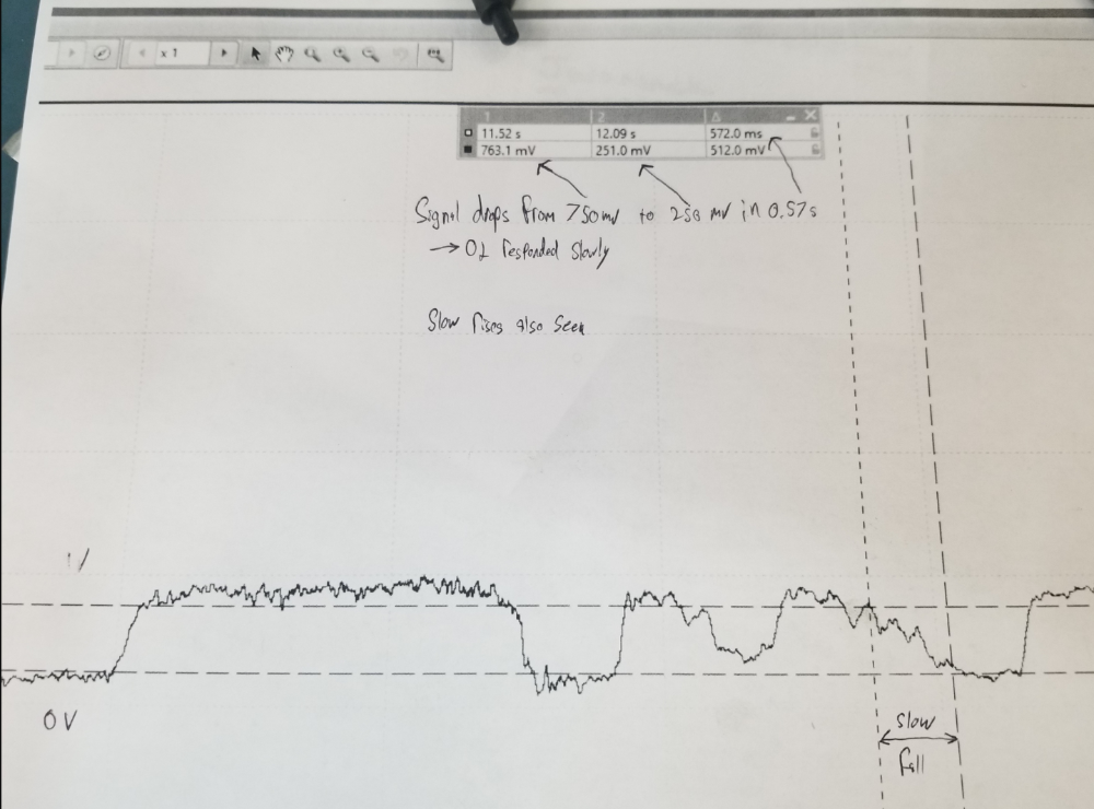

The noise ended up being from a loose banana jack adapter on my probe. I was able to scope the signal with the 12 bit simulated resolution enhancement and found it to be slow. I've attached an image of what I found.

Good to hear you got confirmation of bad o2 as well as diagnosis on the banana jacks. Its a good sign when you catch your equipment having issues before going down a rabbit hole with a car. Bravo

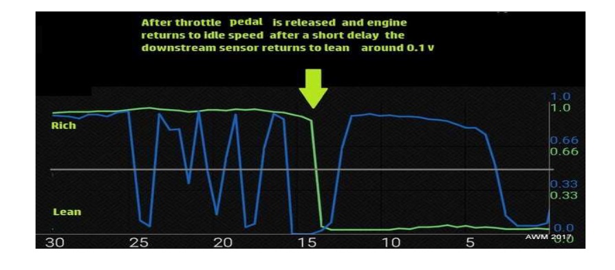

Replied by Andy.MacFadyen on topic 2013 Tahoe 5.3 P015D P015B pre-cat O2 sensor delayed response
When looking at standard O2 sensor response I now use a cheap OBD2 ELM327 dongle with the InCarDoc Pro Android app I found the nice clear graphing it gives is more useful than my Autel and Launch tools.
This is a screen cap from InCarDoc that I annotated
