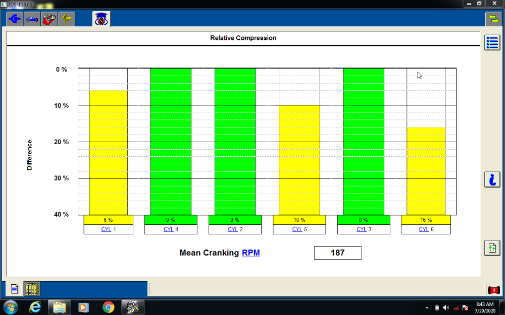

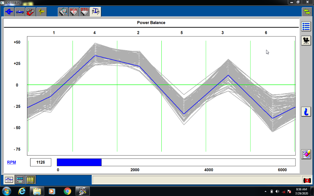

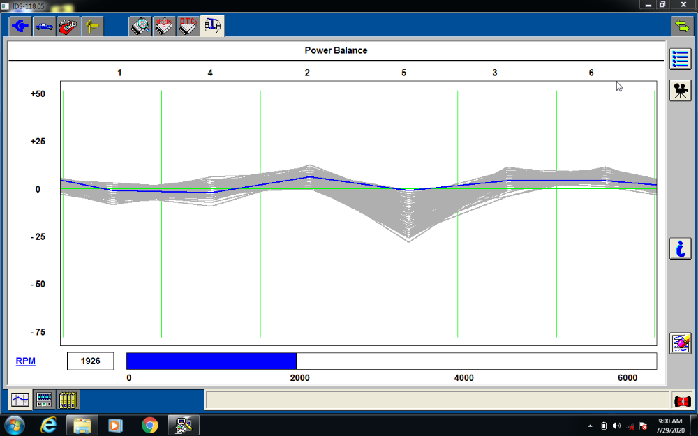

Tyler,
Before I get down and dirty by checking compression of each cylinder and/or a leak down test, would the attached pics of Ford's IDS "Relative compression test" and "Power Balance Test at 1126 rpm and 1926 rpm" be of any assistance?
6 years 3 months ago - 6 years 3 months ago #41805 by Tyler
Smeter12 wrote: Before I get down and dirty by checking compression of each cylinder and/or a leak down test, would the attached pics of Ford's IDS "Relative compression test" and "Power Balance Test at 1126 rpm and 1926 rpm" be of any assistance?
That's what I'm talking about. B) I knew the IDS would do the Power Balance test, but I didn't know for certain if it'd do the relative compression test with this model year.
FWIW, I trust the IDS RC test when it suggests a low cylinder. Here's a link to where I was experimenting with the same test:
www.scannerdanner.com/forum/diagnostic-t...flow-test.html#10022

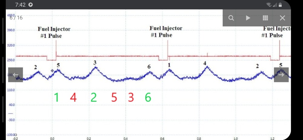

6 years 3 months ago #41810 by Matt T
Smeter12 wrote: Matt T wrote: "That injector definitely ain't firing every 180*".[/size]
Not sure I understand. It is not unreasonable for a manufacturer to spray all injectors every half turn of the camshaft (i.e. one full turn of the crankshaft) when trying to get the vehicle started.... respectively.... am I missing something?
You're missing how a 4 stroke engine works. The intake, compression, power and exhaust strokes are all half a crankshaft revolution/180* so the engine takes two crankshaft revolutions/720* to go from compression stroke to compression stroke on one cylinder.
So it's obvious that injector wasn't firing every 180* because there were too many noticeable compression humps between firings. A 6 cylinder will have one or two compression strokes per 180* not three.
6 years 3 months ago - 6 years 3 months ago #41812 by guafa
Hi everyone,
I am lost with this one. We are looking for fuel trims and misfires, but that compression waveform seems an engine which not even start. Is this engine running?
Why are we watching secondary spikes at every cylinder? Shouldn't be watching 1&5 cylinder spikes?

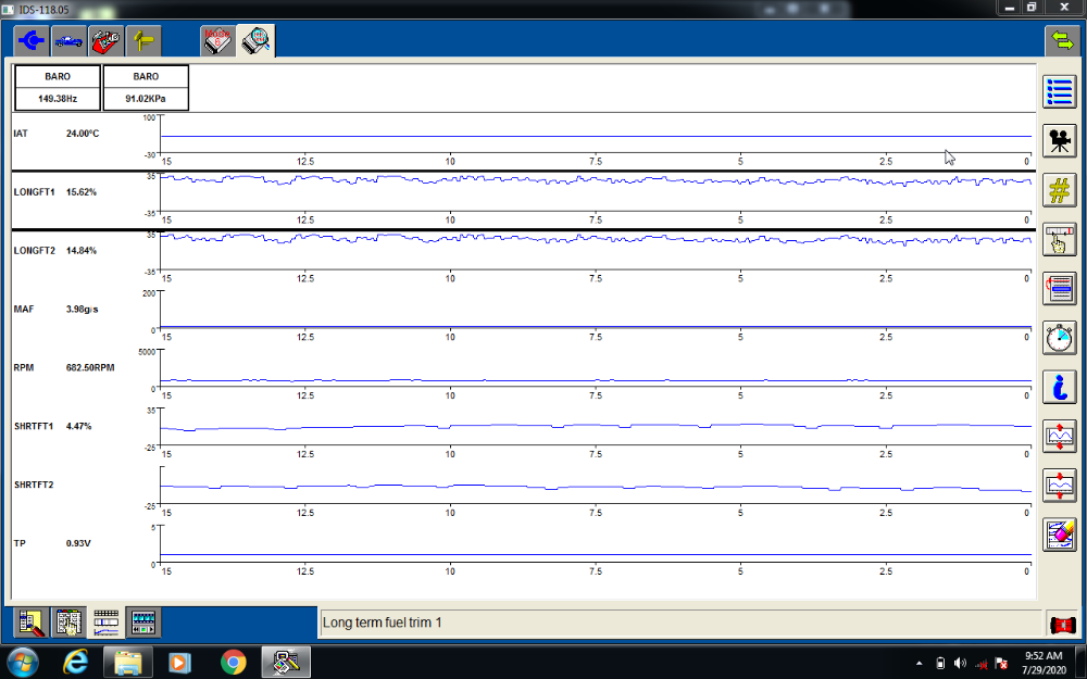

For sh*ts and giggles, I've attached the compression test results from the Ford IDS software to this post (i.e. Pic 7). Pretty cool how the IDS software dialed in the strength/compression of each cylinder and how it corresponds to the gauge compression test results.
CORRECT CONCLUSION BASED ON THE NUMBERS?
I really don't think the pistons (piston and/or its compression rings) are bad seeing that the crankcase could build good vacuum with the breather and PCV valve area blocked off. Instead, I think I have some type of valve train issue in both the left and right cylinder head. Using the fuel trim numbers (noted at the beginning of this post thread and in Pic 26 attached to this post) and the gauge test compression results, I am guessing cylinder 1, 5, and 6 have some type of valve train issue where by the valves (intake & exhaust or both) are not seating properly and are allowing large amounts of intake air (i.e oxygen) into the cylinder [hence the high positive LTFT numbers** at idle (pic 26)] on the intake stroke. Good conclusion?
** when looking at the LTFT numbers, focus on the line graph and how it stays high around 30 and not the 15.62% and 14.84% which simply represent a moment in time measurement as the snapshot was taken

6 years 2 months ago #42255 by Noah
If it were actually firing every 180° it would be evident in this waveform.
This is showing one injection event every 720°
