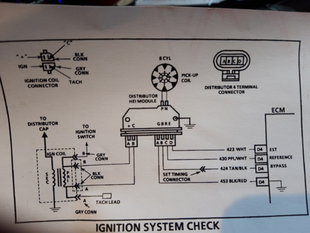

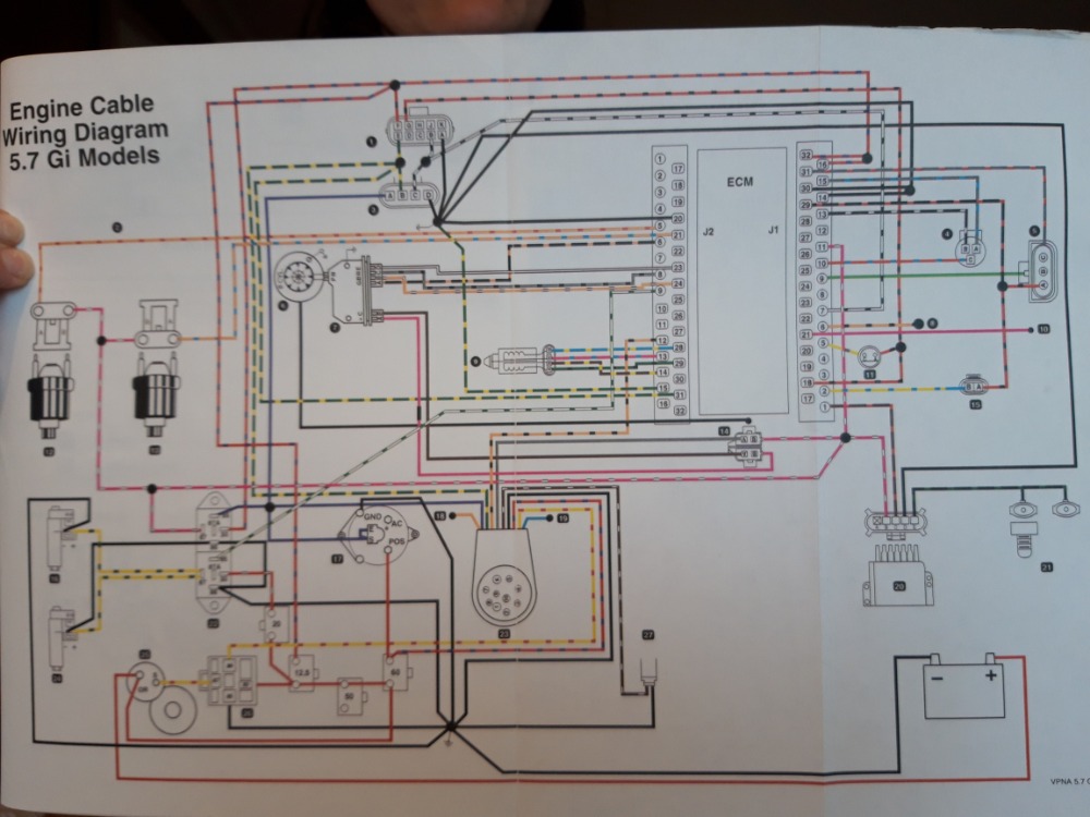

Now i have gotten the correct workshop manual for the engine and if i understand it correctly the blown inductor is not acually a problem that is normal. its not mentioned one place in the whole book. but its drawn in on the circuit drawing.
so what im thinking is that somewhere in the power supplyline that ends up at this conductor must get a spike in voltage of some sort.based on the drawing and my understanding of it, it looks like the power goes from the battery, to the alternator, then to the coil and finaly to the icm. i have changed the coil before blowing two inductor cables. my main syspect at this point is alternator or coil.
i wil try to post a few pics of the drawings.

Here are some pics that might help.

BUT, i have now been talking to a few experts. and both tells me that i have a wiring problem. my ICM is burning up somehow.
my coil side on the ICM is still good. that tells us that our problem is on the ECU side. BUT, we also have ground. i have now been instructed to check 3 things.
#1 go over the 4 cables that comes from the ICM on the ECU side and check voltage readings
#2 check for power leakage into ground (from the ICM)
#3 If leakage into ground find the leakage point.
There is a fair reason to think one of these will get me to the real problem.
the problem has probably been there from when it was rebuilt. has never run longer than an hour before ICM dies. i think ive killed 4 or 5 ICM`s since i tried starting up this engine 1,5 years ago.
i will post my findings.
