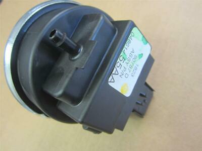

6 years 3 months ago #41818 by Hardtopdr2
Replied by Hardtopdr2 on topic 2004 Ram cruise turns off
Looked up some more info is your cruise control under the hood vacuum actuated? If so use Vacuum guage and check that hose for vacuum while engine is running and driving 20 -30 mph then when it goes over 35 keep an eye on vac gauge see if it looses vacuum.

My vehicle does not use vacuum. It is totally drive by wire. That being said the throttle sensor is located directly below the battery. I have taken all of the connections apart to look for green wires and found nothing. This is the second PCM I have installed because I'm certain it worked prior to the dead coil driver. I still believe it's PCM related but I'm not sure how to prove it.

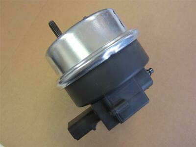

6 years 3 months ago #41854 by Hardtopdr2
This part is what i am refering to. Should be mounted under hood near brake booster.

I have finally gotten back to this repair and I can say that I haven't figured it out yet. The part you are showing me is not on my truck. I only have a throttle cable into the TPS box under the battery. It is a drive by wire gas engine. Thanks for the ideas though.
