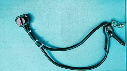

A couple of years back I hacked together this for finding a parasitic draw on a BMW --- just a cheap master swtich and a couple of battery cables to allow an easy disconnect. It is connected to replace the main battery ground cable you can then then connect the multimeter to measure the parasitic drain.
One of the problems is to get a true picture the vehicle has to be fully locked down in a state that puts all the modules into sleep mode often having the hood open can prevent this. One of the tricks I use is to put a heavy weight (2 pound hammer) on the hood open detect switch plunger to fool the alarm and BCU.
Where a parasitic drain is fairly large the main suspects are (1) Anything plugged into the diagnostic socket or cigar lighter socket. (2) Anything aftermarket, ie. Radio head units, cameras, GPS trackers (3) Water intrusion especially if car has modules in trunk --- for example CD changers in spare wheel well. (4) Alternator (5) Screen wiper motor.
