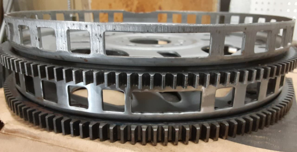

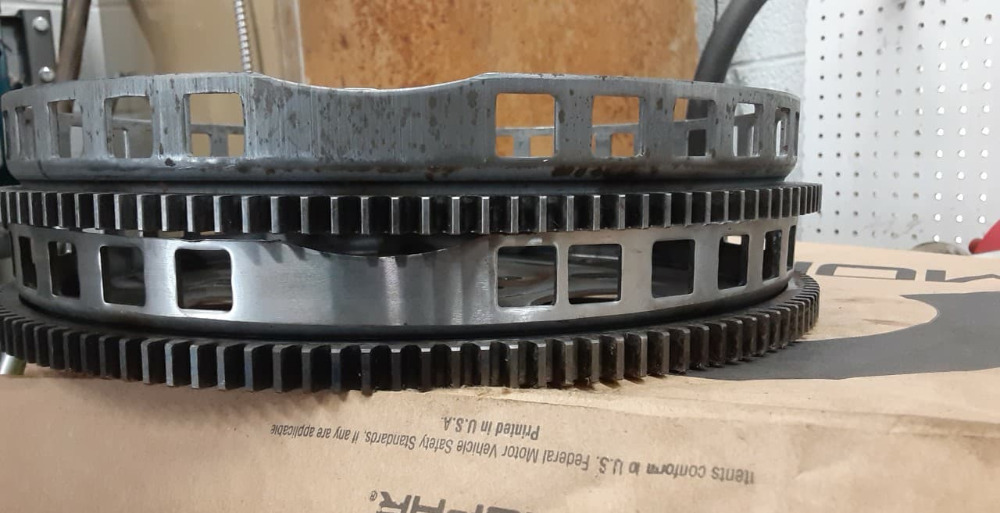

Here you go - nothing about it is right, new on on top in pics....
6 years 3 months ago #41559 by Tyler
Well would you look at that. B) It's not the wrong plate, it was manufactured incorrectly. REALLY incorrectly.
I was right about that one tooth being shorter than it should be, but Matt picked up on what was truly pissing off the PCM. No wonder it had a long crank. :silly:
6 years 3 months ago #41562 by Matt T
ed2 wrote: Here you go - nothing about it is right, new on on top in pics....
Thanks for the pictures. I wasn't expecting it to be that bad. They did do a very nice job of polishing that turd though :lol:

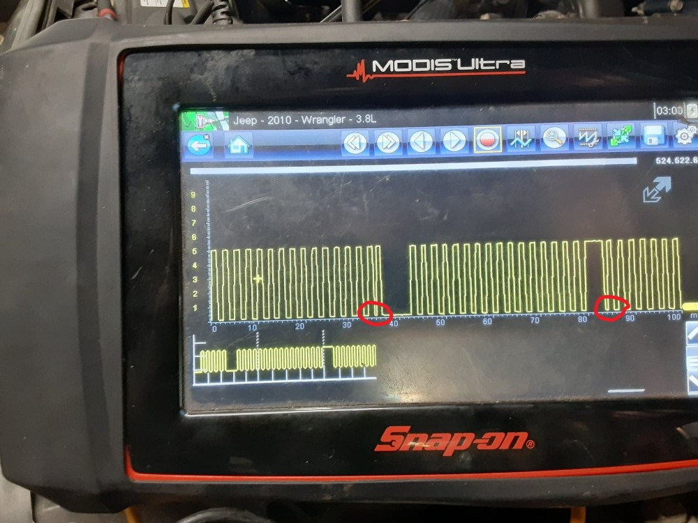

Tyler wrote: I dunno if I'm nitpicking here? But something about this section bothers me:
In every capture, the low section of the tooth right before the sync notch is noticeably shorter than all others.
Apparently you weren't "nit picking". What you noticed matches the flexplate. There are short low sections in the waveform that match the thin flexplate teeth next to both sync notches.
6 years 3 months ago #41583 by Tyler
I was actually trying to decide what symptoms those thinner teeth would have caused, had that extra window not been punched out. :blink: Ghost misfires, maybe? :silly:
So ed2, who get's to pay the bill for that Mopar flexplate?

6 years 3 months ago #41823 by ed2
Sorry been busy, , flex plate fixed problem. also had to remove the Bosch 02 sensors that last shop installed........ but all is good now. Thanks for the help
