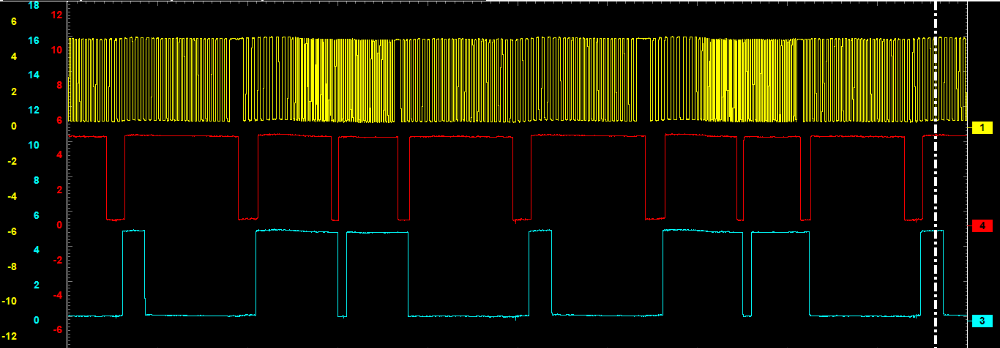

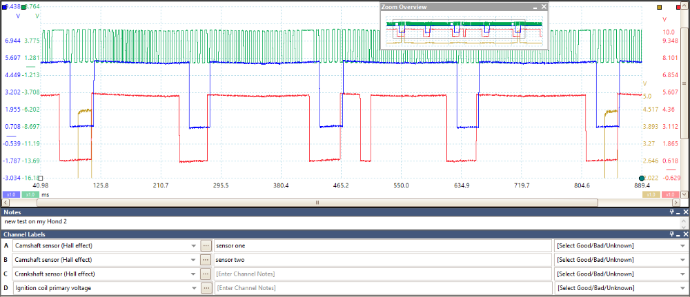

Yes we did. We tried starting fluid. This one really has me thinking so I’m open to any help I can get and thanks to everyone who has responded already. I finally was able to take a cam and crank waveform from it but I can’t get it to upload
6 years 3 months ago #41563 by Tyler
Replied by Tyler on topic Re:2008 Honda Accord 2.4l
Are you trying to upload screenshots? What scope did you use?

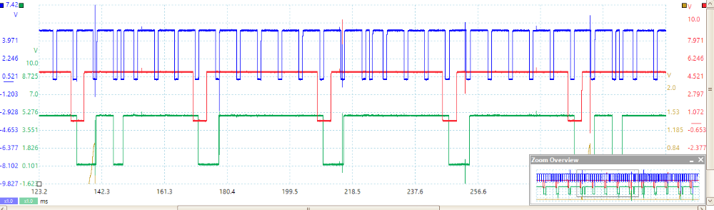

Known good:

6 years 3 months ago #41572 by Da Beginner
Replied by Da Beginner on topic Re:2008 Honda Accord 2.4l
We’re using a pico scope and yes it’s a screenshot.
6 years 3 months ago #41579 by Tyler
Send the .PSD to me. :cheer:

6 years 3 months ago - 6 years 3 months ago #41598 by Tyler
I haven't seen anything yet? I'll keep checking this morning.
EDIT: Never mind, got it!
I'll have to find another known good. :huh: The CKP reluctor wheels are completely different.

6 years 3 months ago #41602 by Tyler
Has this engine been apart recently? Used engine? Chains replaced?
From what I can tell, two things happened around '08. One, the CKP reluctor changed, from 12+1 in the known good I posted, to yours with too many teeth for me to count right now. :silly: Two, the exhaust CMP reluctor changed, from the 4+1 in mine, to one that looks like the trace in blue:
I can't find any waveforms that have your particular combination of CKP and CMP. :angry: In every example I've found, if the vehicle has the new CKP waveform, it also has the new exhaust CMP waveform.
Am I missing something here? :huh:
