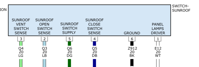

KOEO, I checked powers and ground at the module (which is a part of the motor) and my meter read12.41V and 0V respcetively. At the sunroof switch, I checked wires for the open, close and vent positions and they all read 12.4 V and would read around 4.2V everytime I press on each respective button; HOWEVER the vent button would not command the sunroof to open despite the presence of power and ground. Im suspecting module.
The drk grn wire for theswitch return, read 463 mv...any further suggested testing to confirm if module indeed is fualty, Id appreciate it very much.
Thank you.
6 years 3 months ago #41610 by Tyler
I dunno if it changes anything, but I went and found the OE diagram for the switch itself. I don't always trust redrawn diagram circuit descriptions. :angry:
So pins 2, 3 and 4 only pull down to around 4V with the switches closed? That reading of 463mV, was that with any of the switches closed?
Does the sunroof respond to the auto open and auto close functions?
I agree that it's not looking good for the module. :huh:

what i hv is the mitchell one...yes, sometimes they gv out the wrong diagram but this time the both look the same
anyway, yes all switch pin 2,3,and 4 do drop to about 4V when depressed...now I retested the the sunroof switch return (pin5) and it showed about 1.8mv - i dont why i got 463mv earlier- and when I depress switch2 and 4, pin5 would read about 15mv; and depressing switch3, pin5 would only read about 2.1mv. it seem to me some resistor problem in the module...its pointing more to the module.

There seam to be two intermediate connectors from the switch to the module 1209a and 1309a. This is where the colors of the wire change from dark green to org/ yel. I would ohm these wires from module to switch backprobing to see if you have anything other than 0 ohms. Then see if you can manually vent the sun roof by applying power to vent function of motor. If 0 ohms test current flow with a test light if it lights up bright and vent motor functions then module is the problem.

A fused wire to battery positive and touch the motor feed wire. Looks like that green wire has an issue it should read 0 ohms from end to end of wire.
Also both the module and the switch share the same ground (right side of driver foot well g212)
Would ohm pin 9 of module to ground and pin 6 of switch to ground.

As agreed upon, the owner drove back the car for retesting. I did all power, ground, control, fuses and relay. They all checked normal; ohm test pin9 of module and pin6 of switch and read 0 ohms. I asked her if by any chance she pressed the vent button longer than usual; she couldnt remember. So I did try to "re-learn" all the buttons as recommended by Chrysler. AND IT DID FIX the problem. I rminded her to just press and release the button everytime she wants to sunroof to open.
It could have been an expensive module replacement as intial test pointed to that direction...this car is FIXED
