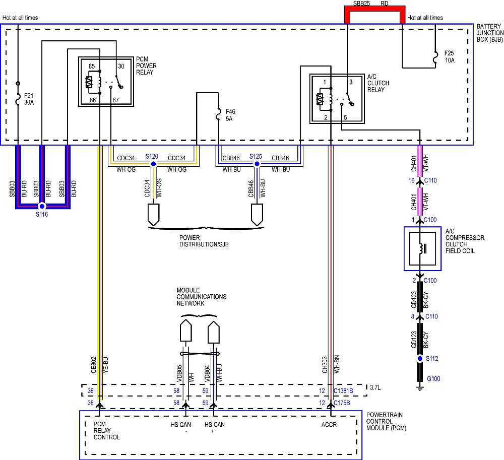

Had a buddy bring me his car saying his a/c is blowing warm after he replaced the blower motor and resistor (Probably just bad timing). He said the a/c was blowing nice and cool prior to putting those parts in.
When i checked it out i noticed the clutch not engaging, checked fuses and relays, all is well. I checked pressures, was a bit low so I evac'd and recharged the system. Still not getting clutch to engage.
I have access to scan tools and such so hooked up and commanded the clutch to engage and it kicked on. I then checked the data for the clutch command and high fan command, neither are being commanded on even with the a/c button pressed and light illuminated on the button. If i command the clutch on with the scan tool while the low fan is on, the ac blows cold, but the high side pressure eventually rises to near 400psi before I have to command it off.
If anyone has any insight on where to look next, or what possible reason the pcm is not commanding either the clutch or high fan on when ac button is pressed please do feel free to comment.
Any other questions that may help i'd be happy to answer to the best of my knowledge. Thanks.

6 years 3 months ago #41687 by John Curtis
Replied by John Curtis on topic 2013 Ford Mustang GT A/C issues
With a test light or a volt meter check right at the Compressor connector for proper power and ground. Here’s a diagram if that ends up checking out. Not much to the circuit.
Can you communicate with the HVAC module?
The following user(s) said Thank You: Dozamen

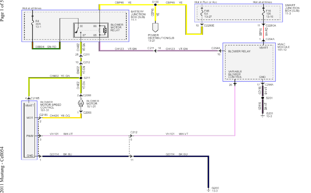

6 years 3 months ago #41691 by Matt T
Replied by Matt T on topic 2013 Ford Mustang GT A/C issues
Don't be so quick to dismiss the blower and "resistor" replacement as "bad timing". Seems unlikely that a '13 would have a dumb, resistor based, blower speed control. See if you can find any blower PIDs. Might even be a blower code set which is inhibiting AC operation.

John Curtis wrote: With a test light or a volt meter check right at the Compressor connector for proper power and ground. Here’s a diagram if that ends up checking out. Not much to the circuit.
I kind of skipped the step of manually checking power and ground at the compressor connector, I assumed those were good since the clutch kicks on when manually commanded to do so with the scan tool. (Maybe I should stop the assuming)
I didn't try to directly communicate with the HVAC module, I will see if that's a possibility with the scan tool I have when he brings me the vehicle again. I was going through the PCM since that's where the option was to test the compressor clutch. Also, thank you for the diagram, that's quite thoughtful of you to take the time to attach for me.

6 years 3 months ago #41709 by Hardtopdr2
Replied by Hardtopdr2 on topic 2013 Ford Mustang GT A/C issues
From what i came across while drowning some bait at the lake. (Albeit this diagram is 2011) is the blower motor is pwm controlled not a resistor type setup so it could be that controller he put in if he has the old one still swap it out and see if it functions like before if not then back probe pwm wire and see what it looks like on a scope. New parts can be bad parts as from what i have seen. As far as getting 400 psi on high side and static pressure of 150 psi both sides i think it may be overcharged cause when the high side gets to 430 psi the high pressure switch disables the air conditioning. What was low side pressure when high side was at 400 btw this part seams like a txv valve sticking. The most you should see for pressure on the high side at 105f is 330-335psi while low side should be 50-55psi at 105f.

6 years 3 months ago #41765 by Dozamen
Replied by Dozamen on topic 2013 Ford Mustang GT A/C issues
Hardtopdr2 wrote: From what i came across while drowning some bait at the lake. (Albeit this diagram is 2011) is the blower motor is pwm controlled not a resistor type setup so it could be that controller he put in if he has the old one still swap it out and see if it functions like before if not then back probe pwm wire and see what it looks like on a scope. New parts can be bad parts as from what i have seen. As far as getting 400 psi on high side and static pressure of 150 psi both sides i think it may be overcharged cause when the high side gets to 430 psi the high pressure switch disables the air conditioning. What was low side pressure when high side was at 400 btw this part seams like a txv valve sticking. The most you should see for pressure on the high side at 105f is 330-335psi while low side should be 50-55psi at 105f.
This was it, I called him and asked if he still had the original part and told him to throw it back in, worked like a charm. He said the blower motor would cut out on him a lot lately so he changed both parts. I didn't realize it was a pwm controlled. I'll be sure to pay closer attention to things in the future. Thank you for your input, definitely saved me a headache.
