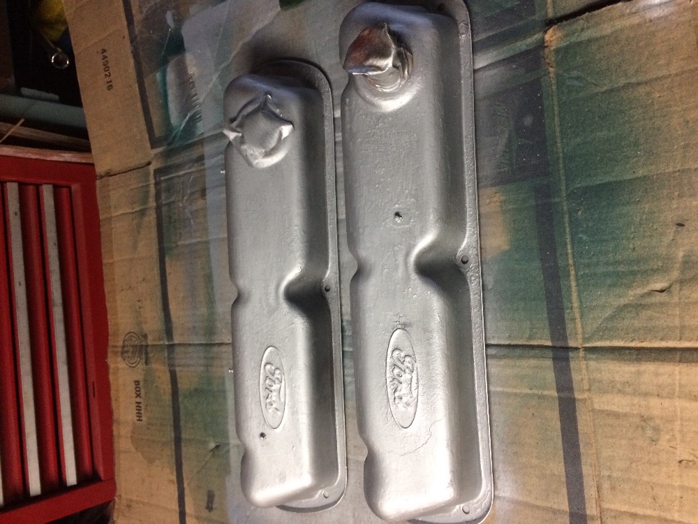

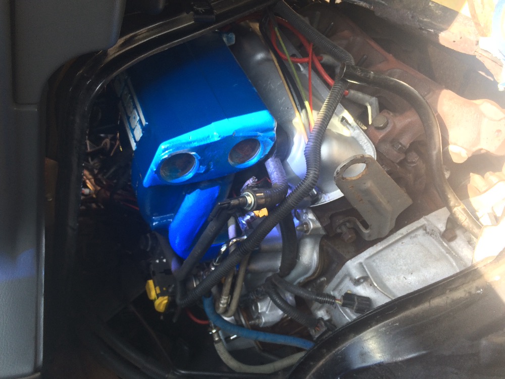

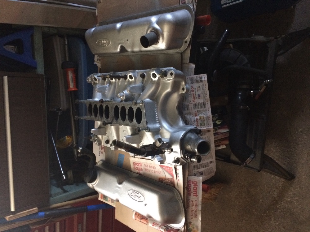

I live in pittsburgh, pa, I'm 65yrs old, i'm in the community of brookline, in the south hills. Most of my life i was a letter carrier, and very little experience tearing apart an engine,
Since mid june 2020, I have been tearing apart my engine on a 1996 Ford E150 5.8L EFI ,
took the van for a test drive today, for the first time, after making sure the idle was ok, and everything else was ok, well i couldn't get any power to climb a short hill. Engine didn't stall, it didn't have any acceleration as i pressed the on the gas pedal. Anyone know why? In park, i was able to rev up the engine, (in gear, no acceleration or power),
I have the van home now, the van starts fine, idle is iffy, till i turn the ac on, the engine will rev up, rpm's(i don't have a guage , i don't know, I never set the timing after installing a new distributor, I just placed it in as close to the same spot of the old distributor.
on level street, it accelerates and moves just fine, but no power to move up a hill, why?
Every day I start the engine, it starts up and idles better than the day before!
Today 08/03/2020 van starts ok, idle is fine, oil is clear, coolant level still the same after a week of running engine, since on july 5th I had first started van forcing it idle after putting engine back together with all clean parts, and had a coolant leak inside the intake manifold and coolant mixed with oil in the oil pan, which i drained a gallon of coolant and a few qts of creamy coffee colored oil
Today 8/5/2020 the idle is worse than ever, the belt tensioner makes noise, and wobbles way too much for some reason. this van cost $2500 to buy in oct 2019, and since then I have put another $6,000 into parts and tools included. and lots my own labor. $3500 to have the transmission rebuilt.
I'm ready to just give up, because instead of fixing i might have ruined the engine, maybe the catalytic convertor, maybe the pistons or rings, maybe the valves, idkk. maybe its just out of timing, I don't know
I'm thinking of for a 3rd time, removing the upper intake plenum and passenger side valve cover to check rocker arms and rods, check visibly the condition and movement, There does seem to be noise coming from under that valve cover, or should I work on setting the timing? I did a compression test,, no.1 is 126 no. 2 is 126, no.3 is 126, no.4 is 145/ not sure what those numbers mean.....if its good or bad? maybe I should do a wet test, with a bit of oil
