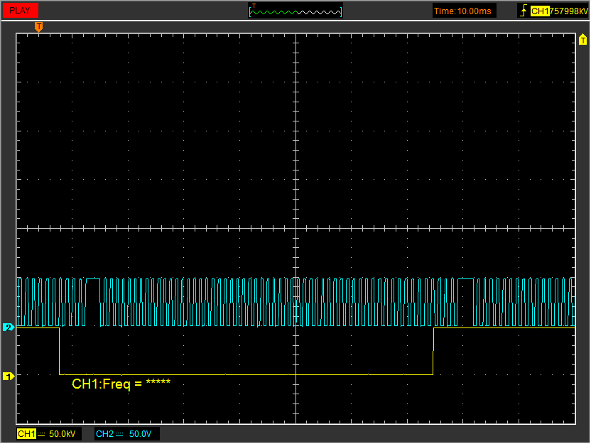

9 years 8 months ago #6367 by Tyler
Replied by Tyler on topic 2004 HYUNDIA TUSON
I got your message, d auto, nice job with getting the images to work! :cheer:
Your first image is a cam/crank capture? Finding a known good was tough, the closest I could come was an '06 Kia Spectra. Still, your image matches the known good. Supposedly, the rising/falling edge of the CMP signal (yellow in your capture) is supposed to fall within 3 - 5 crank teeth of the sync notch, and yours looks to be within that range.

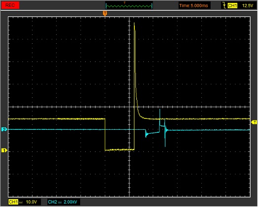

The second looks like an injector and an ignition event. The scaling on the ignition is bit off, but the burn line seems to have a slight downward slope to it. Definitely supports what the O2's are saying about the lean condition of the exhaust.
Have you tried adding alternative fuel to the intake, and see if the engine runs any better?

9 years 8 months ago #6480 by dauto
Replied by dauto on topic Re:2004 HYUNDIA TUSON
Replying to lean i have done that spray into intake but that is not what causing the popping and back fire it seem take a look at picture i post
9 years 7 months ago #6606 by dauto
Replied by dauto on topic 2004 HYUNDIA TUSON
when check the timing from the cam it was off when set again the vehicle run with out popping and back fire as i accelerate it would not shut down any more
